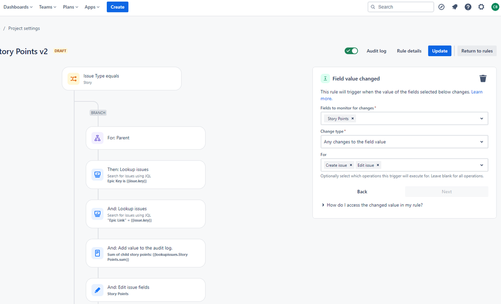

Here is the first  (didn't have room to capture the entire screen but the first steps is the one at the right "Field Value Changed")

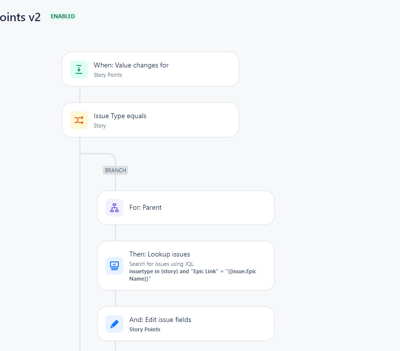

Here is the second one I tried
In the story points field I used
{{lookupissues.Story Points.sum}}

@Jehan Bhathena provided information about a version of a rule that could work for you. I want to address why what you have did not work.
To really explain why they didn't work though, I need to know in what way exactly do each of these not work? Without that information I can point out some possible problems.
In the first one you have two Lookup Issues actions; one based on something you called "Epic Key" and one based on "Epic Link". What is the one based on "Epic Key" supposed to be doing? Do you have a custom field named "Epic Key"?
Also be advised that the second Lookup Issues action overwrites the results of the first one. If you actually need to retrieve two sets of issues and combine the results; with one issue set based on Epic Link and the other based on Epic Key, those selections need to be combined in one JQL in one Lookup Issues action.
In the second rule the Lookup within the branch is wrong. You can't use the Epic Name from the Epic as the value when searching on the Epic Link field for child issues. You would need to use
"Epic Link" = {{issue.key}}
Additionally, Atlassian is deprecated the "Epic Link" field and replacing it with the "Parent" field. In many systems they have already disabled the ability to use the "Epic Link" field in screens and filters, or provide warning messages when the "Epic Link" field is used. This may not yet be true in your instance, but you may want to check on that.

Thanks for the response. In both cases (where user error is highly likely) "doesn't work" means that even though the Epics have many child Stories with Story Point values, the Story Points field in the parent Epic cards remain blank.
I will also give your Epic Link suggestion a try.

I see several errors in the rule image you posted, with invalid smart values: case and typos.
Smart values are name, spacing, and case-sensitive.  When an invalid one is used, the rule uses null, and that often fails silently (with no error in the log).  The smart value for Lookup Issues is this:
{{lookupIssues}}
And so for a company-managed projects, the sum of the Story Points from the lookup would be this:
{{lookupIssues.Story points.sum|0}}
Please try that in your edit, or write it to the audit log, to observe any differences.

Please remove the extra spaces or the smart value expression will not work:
