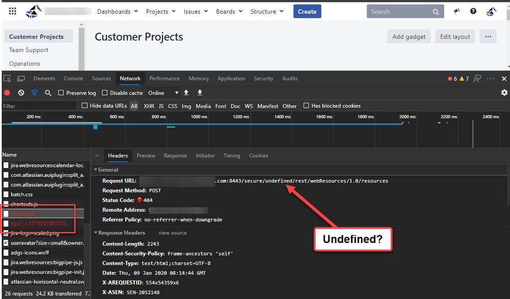

We have the same issue. Seems that URL for "resources" and "tips" are failing with 404, adding /undefined/ in the URLS
Use the inspect function in browser, network tab, to check if you guys see the same. For the admin users the "tips" URL is not requested at all.
