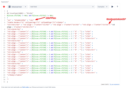

I have a question. Does anyone have experience with JWT Calculated Textfield? I want to build a risk matrix (4x4 Matrix) and have created an HTML code. However, it is not working. I am not getting a table structure. Can someone help me with this?"
Thanks in advance.
Leena

I've noticed that there were a couple of things which had to be fixed from the expression you wrote in your message.
Before giving you the expression corrected, please take a look to this screenshot to have a better understanding of which parts were missing:
As it's mentioned in the screenshot, it seems that there was mising a "+" symbol and also closing the quotes in the lines 5 and 6 from your expression. Here you have the expression modified, now it should work as expected!

Could you please try using these expression and let me know if it worked?

One problem I am facing is with the display view; it is not showing in a tabular format. What could be the reason for this?
