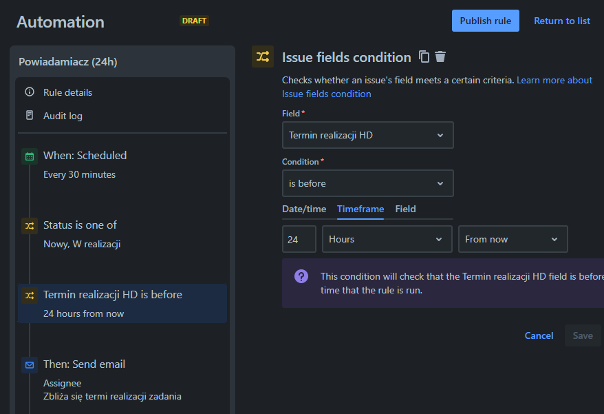

I've seen many automation topics related to my problem, but I haven't found a solution there, so maybe I'll give you my specific case.
I want to set up notifications for our helpdesk so that the assigned person receives an email a day, 12 hours and 3 hours before the deadline. The duedate option will not work because there is no specific time, so I added a timestamp for tickets. I created various limiting rules, but in each case I received e-mails for each case (e.g. 3 hours before the time I also received them for earlier ones). It may be simple, but I think I'm too confused in it.
On the screenshot, the original rule (separate for each time), without other IF rulesBez tytułu.png

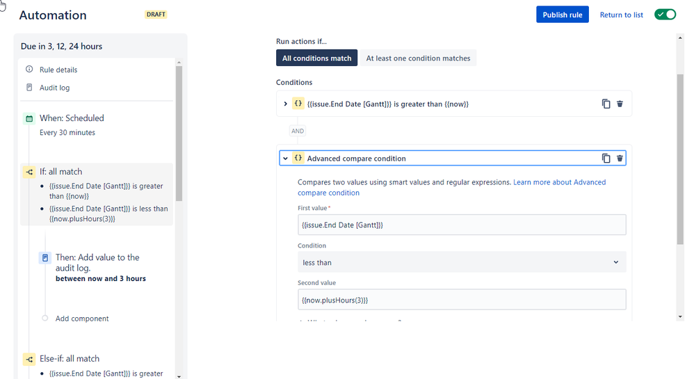

Here is how you can do it in a few steps. Note that my date/time field is called End Date [Gantt]. You need to replace that with the name of your field.
  1. Trigger: Scheduled every 30,
    Use a JQL with: "End Date [Gantt]" > 0m and "End Date [Gantt]" < 25h
    And make sure the checkbox 'Only include issues that have changed...' is not checked.
    This will prevent that you have too many issues
  2. Add an If else condition
  3. Add an advanced compare condition (all conditions match):
    First value: {{issue.End Date [Gantt]}}
    Greater than
    Second value: {{now}}
  4. Add another advanced compare condition:
    Greater than
    Second value: {{now.plusHours(3)}}
  5. Add an action, e.g. email the assignee
  6. Copy the if-block and
    Change the second value of the first condition to: {{now.plusHours(3)}}
    Change the second value of the second condition to: {{now.plusHours(12)}}
  7. Add an action, e.g. email the assignee
  8. Copy the else-block and
    Change the second value of the first condition to: {{now.plusHours(12)}}
    Change the second value of the second condition to: {{now.plusHours(24)}}
  9. Add an action, e.g. email the assignee
The first condtion block will look like this:
Good luck

Works! I didn't know I could use issue.XXX like that..
There's still a bit of learning ahead of me ;)
In point 6 and 8 instead of greater it should be less and then it works perfectly :)
Thank you very much!
