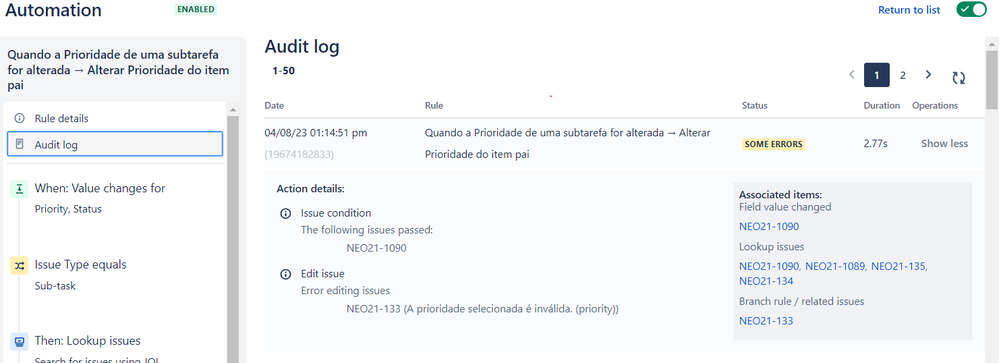

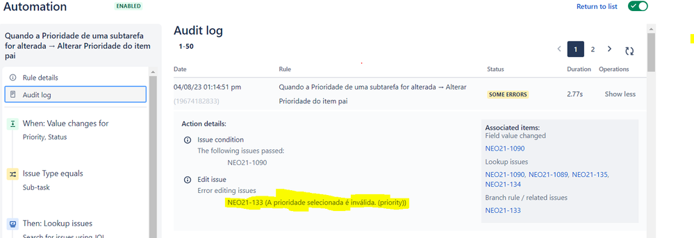

Could you also paste as text the message in the log, so that I can run it through a translation app?
Where you have used the smart value to set the priority field, the "i" in "lookupIssues" needs to be capitalized.
I hadn't really seen this detail but unfortunately the watering doesn't work.
The translation of the text would be marked:
The selected priority is invalid. (priority)

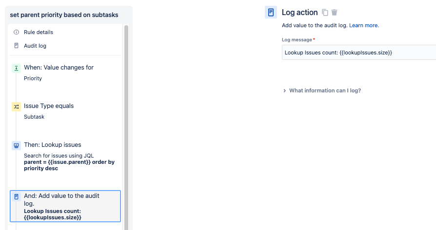

Please add a step after the Lookup Issues action to print the smart value for the count of issues found into the Log. This is done with the Log action.
Lookup Issues count: {{lookupIssues.size}}

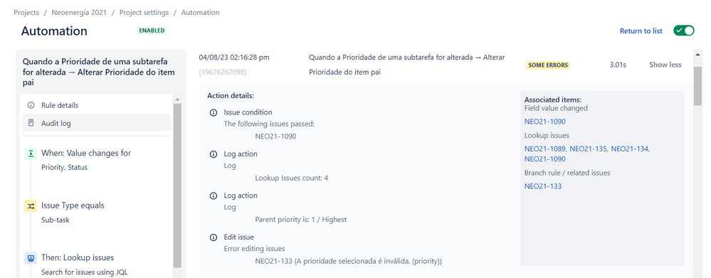

Please add a step before the Edit action to print the smart value into the Log. This is done with the Log action. Print both the value and the name associated with the value.
Parent priority is: {{lookupIssues.first.priority}} / {{lookupIssues.first.priority.name}}
Run the rule again and review the log. It should show you a numeric value for the count of issues found by the Lookup action and a numeric value for the priority and the text name displayed for that priority.
Is the count of issues found greater than zero?
Is the priority value a value that you could set manually on the parent issue?
Thanks for answer @Trudy Claspill ,
This was the result of the audit log.
I'm using a company-managed proje
That confirms that the Lookup is finding issues, and the first one in the results set does have a valid priority value.

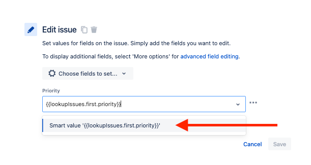

Can you show us the details of the Edit step again, since you changed it? I want to confirm that is contains the following without any typographical errors.
When you were entering the smart value, did is show you the pop-up below the field as you typed? And did you click in that area to insert the value you typed into the field?
It worked now, There was a space at the beginning of the smartvalue text...
