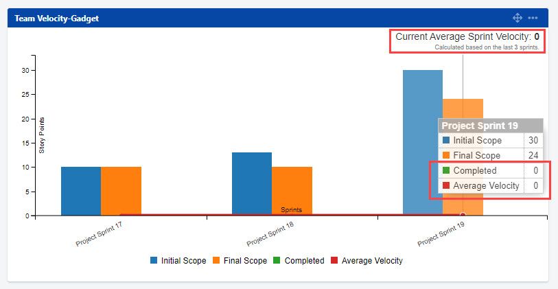

I have added Team Velocity - Gadget in my JIRA dashboard. I have setup it to display the average velocity of team using last 3 sprints, calculated by story points.
We are currently in 20th Sprint, and definitely completed stories in previous sprints.
However for some reason (that I don't know), this gadget is showing current average velocity as "0".
Please see below screen shot.
I will appreciate any input and feedback to fix this.

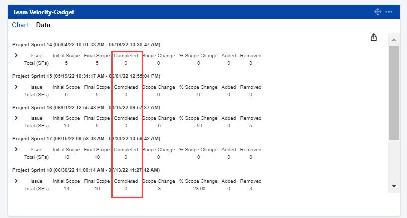

@Bill Sheboy Thanks for pin pointing to the root cause. I checked the data view of the gadget, and validated that the completed issues are coming as zeroes. Please see attached.

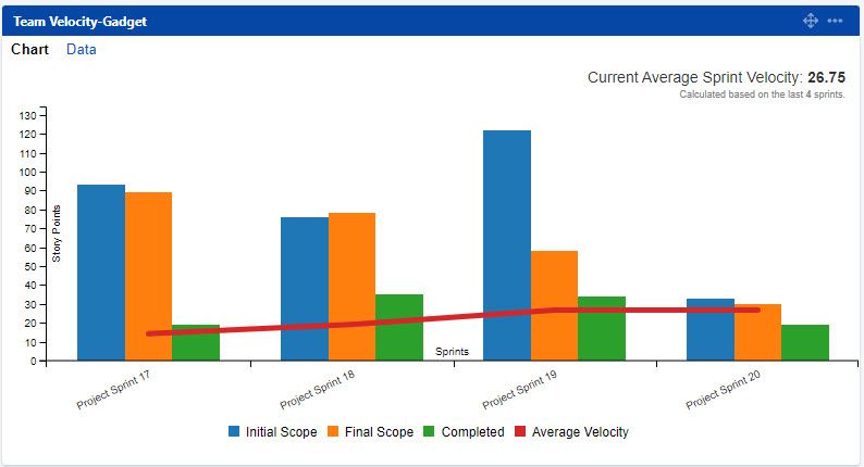

So, I created a new dashboard, and use that in the gadget and the data came right, hence the average velocity. Please see below snashot.

Did you select the same board, and the same sprint filters, with your new dashboard versus the original one?
And, if you expand the data table entries (by sprint), do you see what you expect for the sprints?
I created new board with simple filter query.
project = PSC AND Team in cascadeOption(45408) ORDER BY Rank ASC
And, yes, when I expand the data entries, it shows me what I expect from sprints i.e. No. of completed stories are not zeroes.
