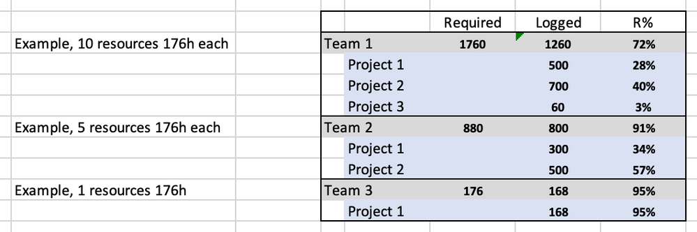

Could you tell me how to make such a report?

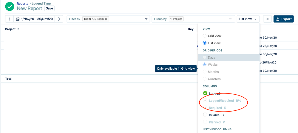

Tempo timesheet cannot, I asked the vendor. No grouping by teams.

Assuming you do have Tempo Timesheets already, you can create reports for the individual teams (filter by instead of group by) which you them group by project.
In my mind it's then a fairly small step to export / copy-paste those data into a spreadsheet like you did to illustrate your question.

the problem is that we have a lot of teams, and the report is needed weekly. in addition, the proposed report does not display the capacity column

You could build a spreadsheet template that holds your Team capacities. So the additional information that you don't have in your reports can be calculated and added from your spreadsheet. You could export all worklogs across all teams from one Tempo report and do the grouping magic in a pivot table.
Or you could use any proper reporting tool that has the capabilities to aggregate and group data the way you want to. EazyBI is one of them, but if your company has other reporting tools already on board (powerbi, tableau, ...), that may work as well. As long as you get the raw data in there.
