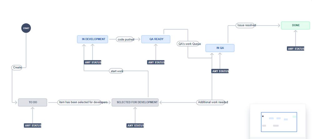

I seem to be unable to remove the 'to do' column from my kanban board on a team collaborated project. I'm the admin on this board and ideally new I would like all newly created tickets to be set to go to the backlog. If I remove to do and have a backlog all the newly created tickets go to 'selected for development' or somewhere else on the start of the workflow. I want a place to park tickets until we decide as a development team to pick them up. Here is a picture of the current work flow I'm trying to change:

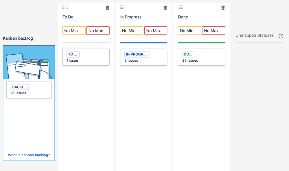

Kanban boards in company managed projects. There you see the behaviour you would like to see, as you do map your first status to the backlog column of the board, as you can see in this example:
