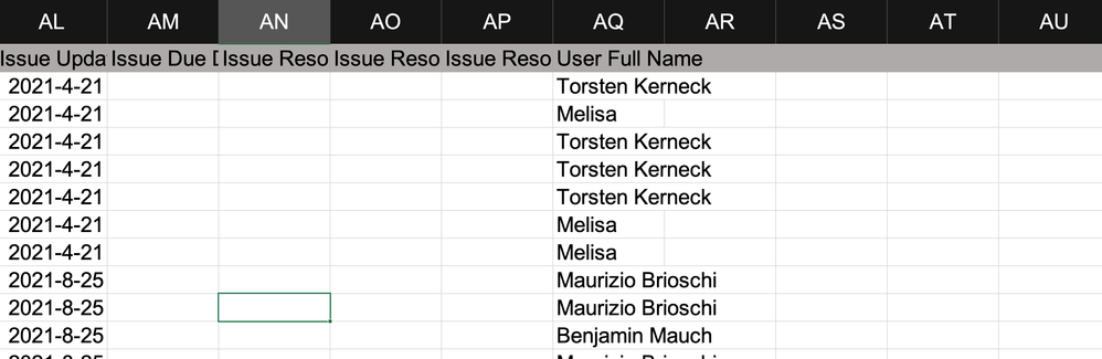

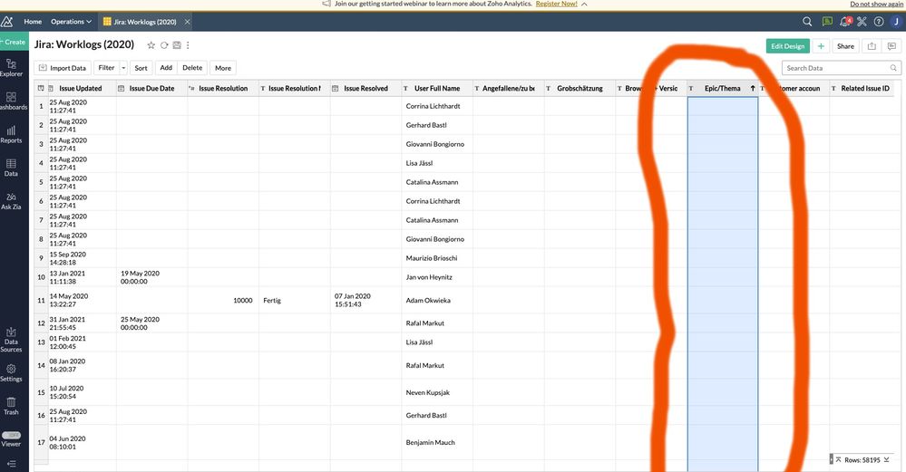

The problem is that the epic links are not exported with the data
so I need help please. The data till the 8th or 9th column is exported perfectly but after that all columns are empty. is it maybe a limit in the export?
