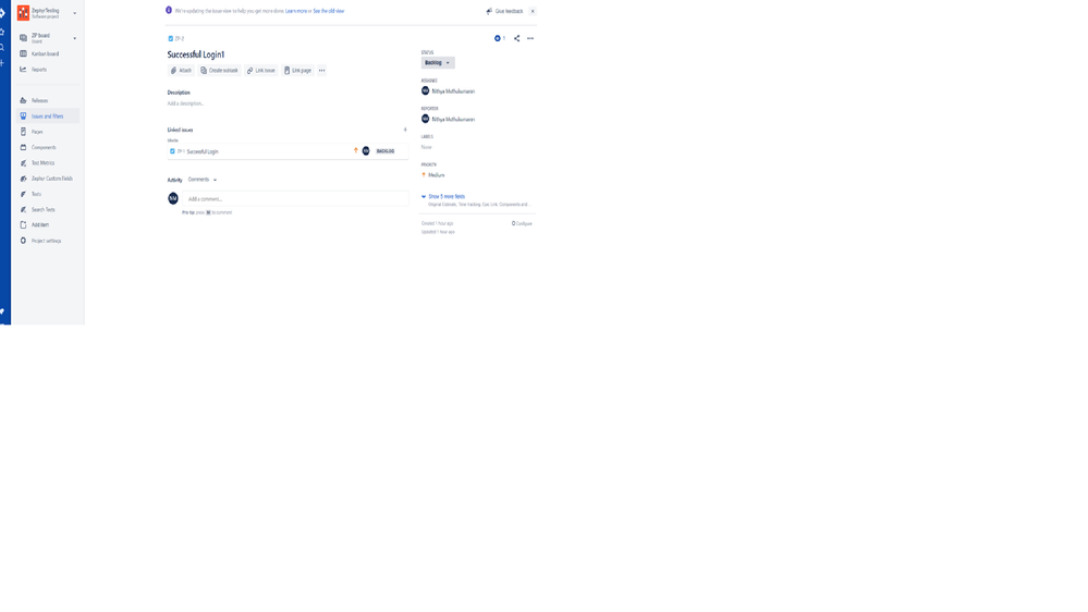

I am new to JIRA software. I tried to install the trial version of th eJIRA software and Zephyr to work on Test cases.
After installation, I couldn't find the issue type of Test. So I created the new one and added it to the project.
I created an issue and tried to edit the issue to include the test steps, test data and expected results. However, the issue does not display any test related fields.
Tried the general configuration for Zephyr but the new issue type is not listing.
  • Show Create Zephyr Test on Issue Type(s)
Also when I try to link the other issues to this field, it is still not showing the test case field options.
Can you guide me through on how to resolve this issue? As I am on the trial version,  I would appreciate if someone could help me out ASAP.
Thanks in advance.
Attached the screenshot of my test issue.

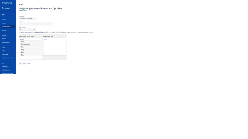

NithyaSE September 27, 2019
@jagadeesh madhura - the issue type "Test" is available in my current scheme.
This is for the Zephyr on JIRA Cloud.
My problem is that the created test does not show the "Test details" field to include the test steps, test data and expected results.
Since I am on trial version, not sure if downgrading by uninstalling the app is the best option.
Based on the Atlassian community discussions, few others too have this issue.
