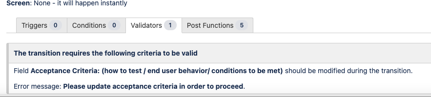

Yes, that is what I have chosen. It works, it actually works TOO well.  Even after i have updated the text in the field, it won't allow me to move the ticket forward.
Any thoughts?

So, I managed to recreate your issue, thanks for the screenshot. The validator only seems to work when you have a Screen associated with the transition (a screen appears when performing the transition).

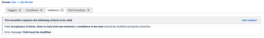

3. Add the same validator as before;

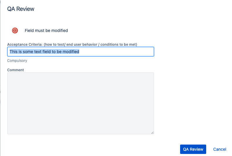

4. During the transition, you'll get the following screen;
