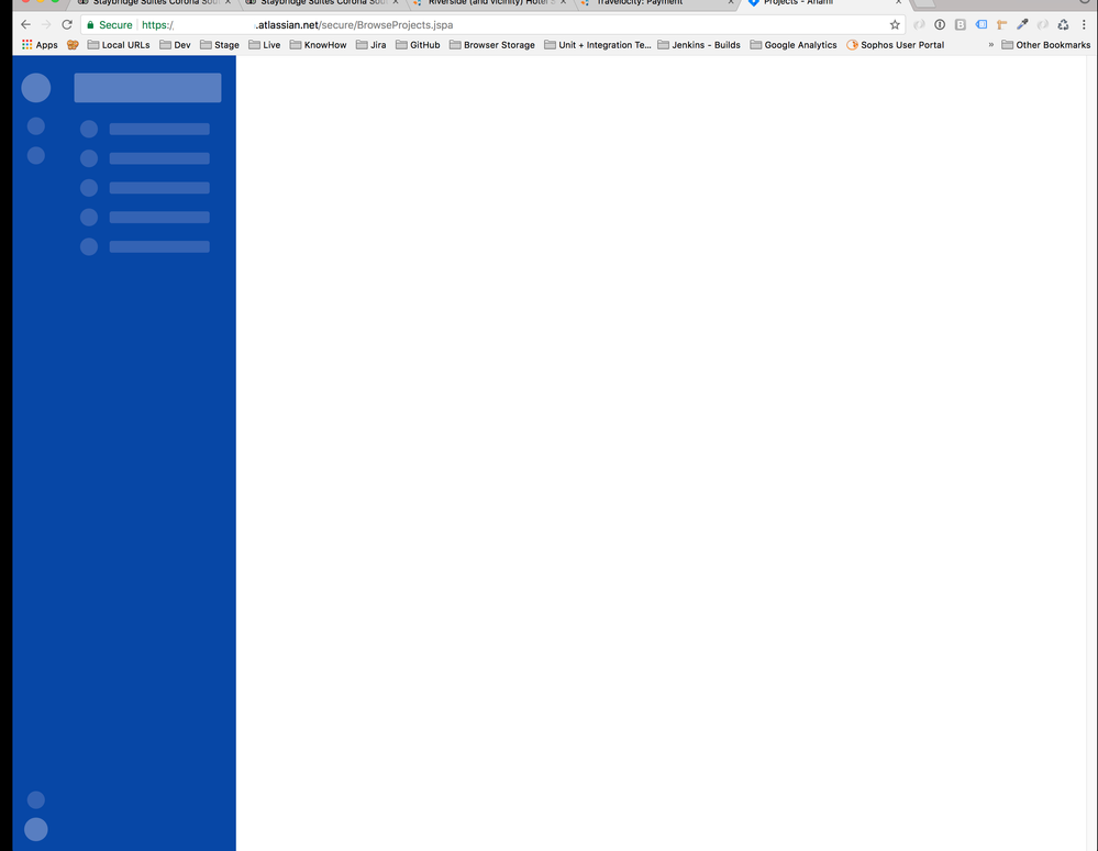

I click on the All Project link from left nav... it loads...
https://xyzcompany.atlassian.net/projects?selectedCategory=all&selectedProjectType=all
and it doesn't show anything?

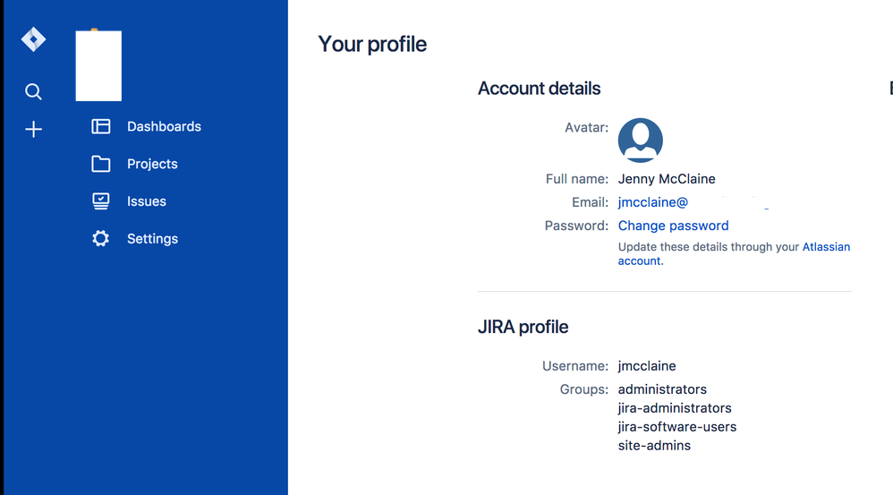

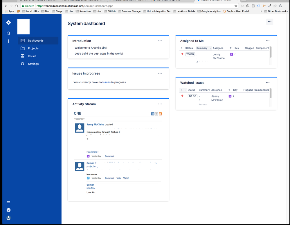

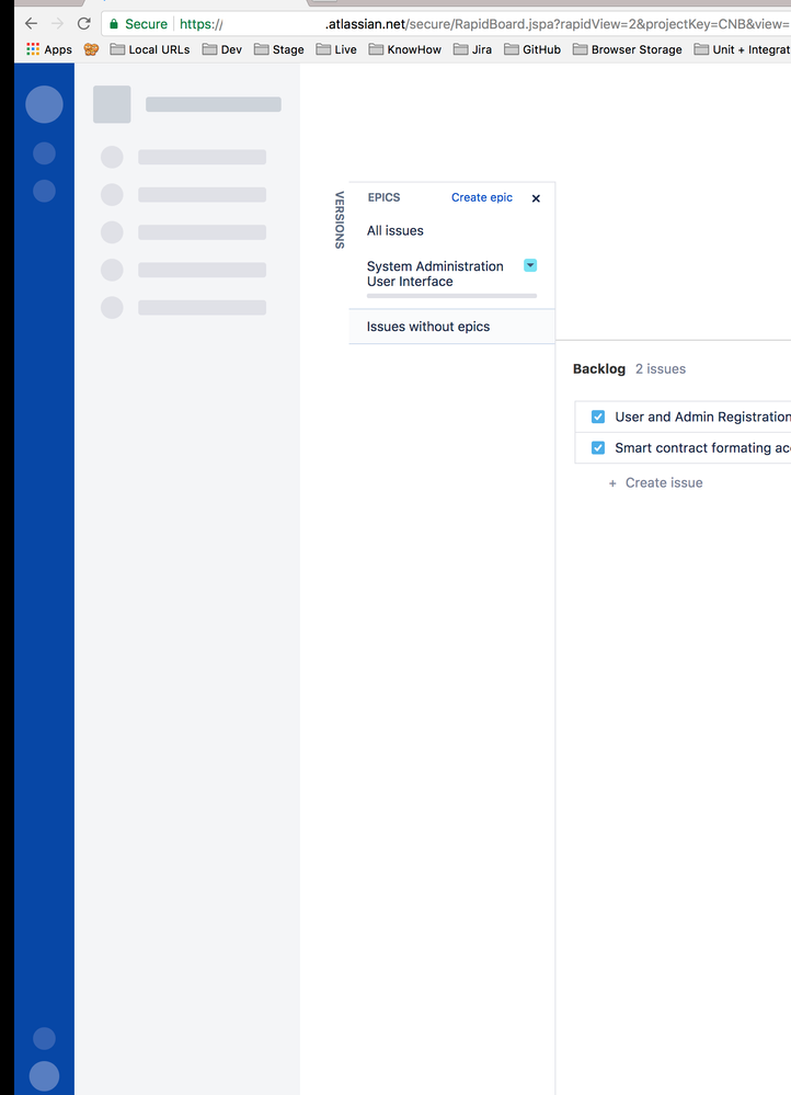

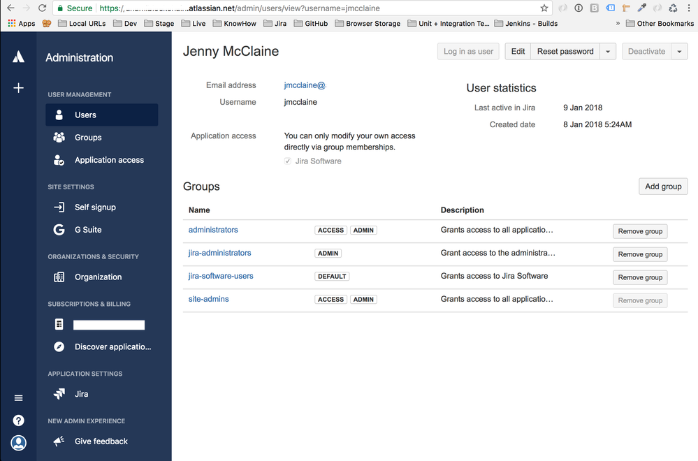

Yes, I'm an administrator, see attached screenshots, lot's of views are missing left nav making it impossible to navigate.

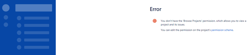

@Jenny McClaine i tried to reproduce your case.
Very similar view i got only when move out a permission to Browse Project from administrator. My screenshot is below
But i see on your screenshots that you can browse issues in projects. It means that you have rights to view projects cause with out this permission you will not see them even if you created them or they are assigned to you.
