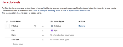

Regarding bugs, there is no reason why Portfolio could not display those. If you want them to, make sure you map the issue type bug to the Story hierarchy level of Portfolio and include them in the filter / board that you set as the issue source for your Portfolio plan:
screenshot from Portfolio / Administration / Portfolio hierarchy configuration
On a side note, make sure that you will need to estimate bugs in order to have them processed correctly in your plan schedule. If you don't have that practice, it might be better to reduce your team's capacity in accordance with the amount of time you expect to be spending on bug fixing.
