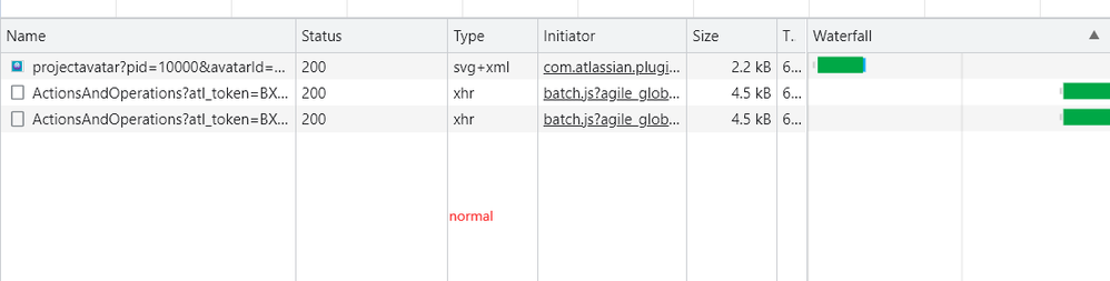

1. When accessing the server ip, click the applet to be normal (gadget)

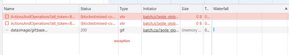

2. "The Jira server could not be contacted. This may be a temporary glitch or the server may be down" will appear when accessing through the server ip or domain name after proxying through nginx
Request URL: “http://xxxxx.com/rest/api/1.0/issues/xxxxxxxx”

The following is the screenshot that appears when you click on Actions in the gadget after accessing through ip and proxying with nginx
cheung April 7, 2022
It seems that this error will occur when using nginx proxy to go to https. It is normal to go to http instead of https.
Does anyone know how to deal with this situation of going to https? I look forward to the answer, thank you
