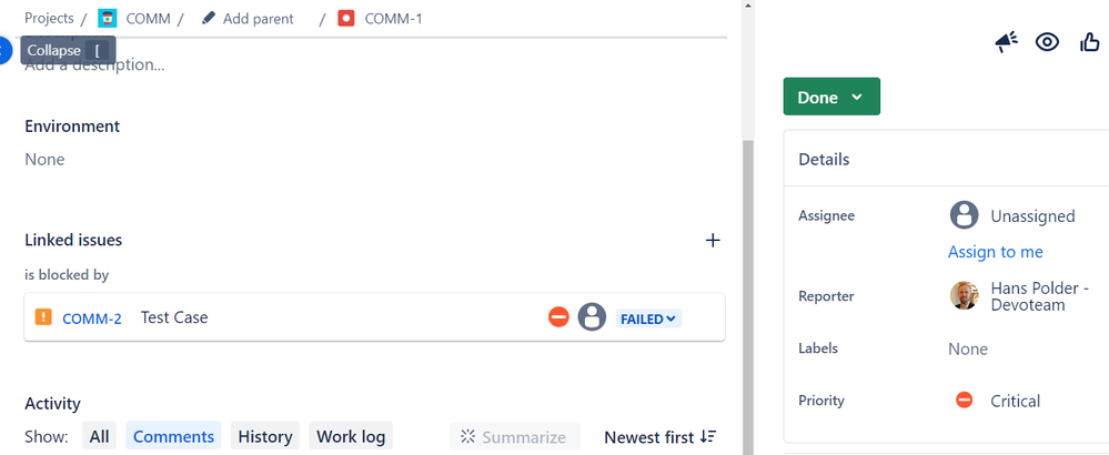

Otherwise, we could try to dive into the issue at hand. Just to validate, is below mock-setup indeed the situation you're dealing with? Or did I misunderstand? Also, I'm curious: Do you happen to have the Scriptrunner plugin from Adapatavist installed on your environment by any chance? They have a lot of options to find these specific linked issues. I'm not sure Jira search options that are available out of the box would fully satisfy your request.
