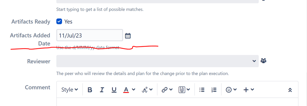

The issue here is,  Whenever someone selects the "edit" option on a ticket to update other fields, the "Artifacts Added Date" field is automatically updated. This happens even if the field has already been checked "Artifacts Ready" = "Yes" or filled in with a date, as it will always update to reflect the most recent date.
How to avoid this when using behaviors ?

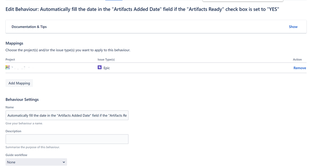

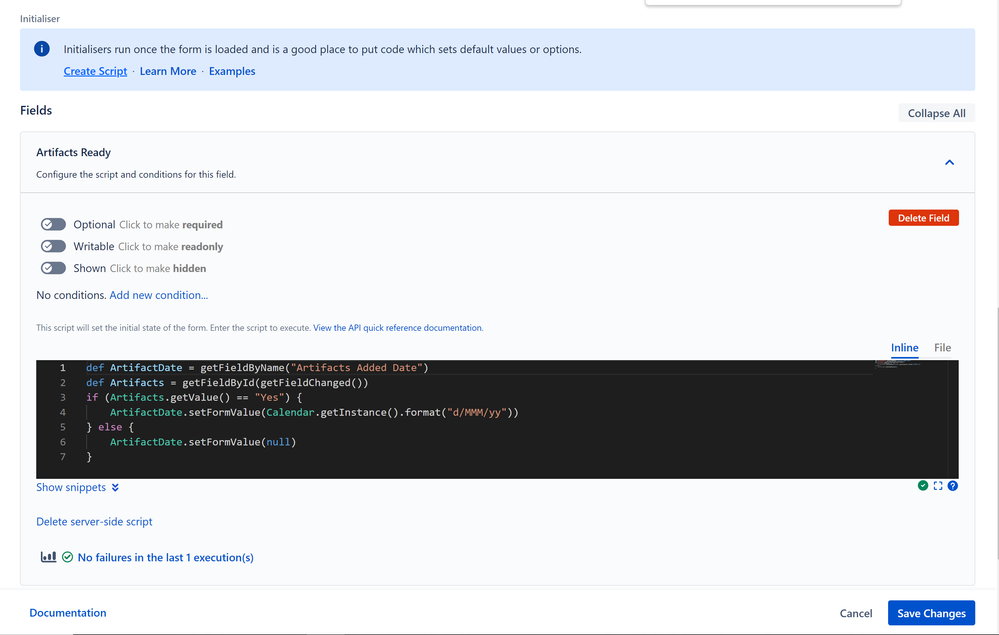

Hi @Ram Kumar Aravindakshan _Adaptavist_ , Thank you for the quick responses.
I have included a server-side script, however, whenever the user attempts to modify other fields on the edit screen, the "Artifacts Added Date" is automatically updated to the most recent date.
Please find attached screenshots for your reference.

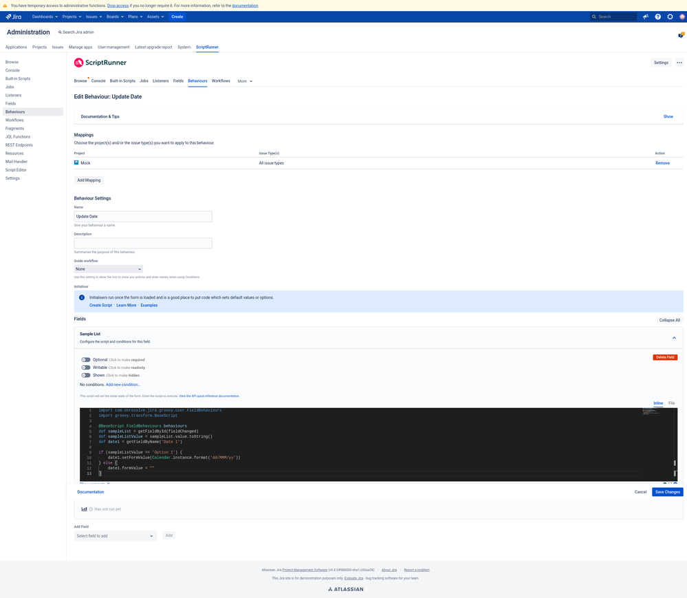

Below is a screenshot of my Server-Side Behaviour configuration:-

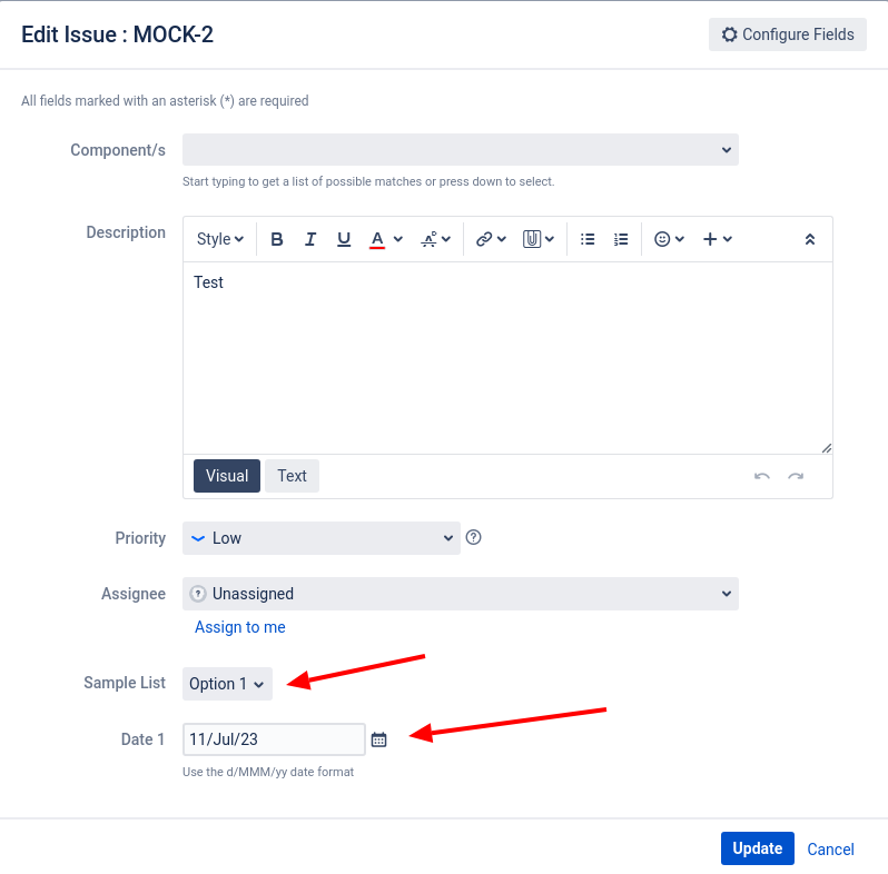

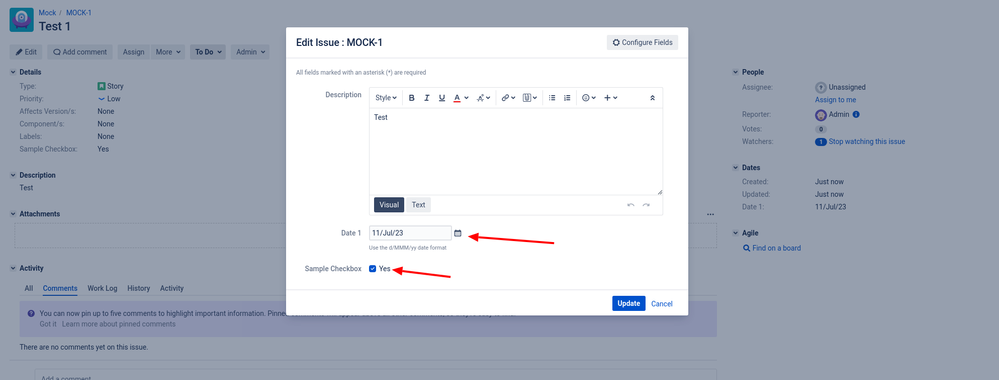

I have run a test on my environment, i.e. the Edit screen and it seems to work as expected.
Below is a test screenshot for your reference:-

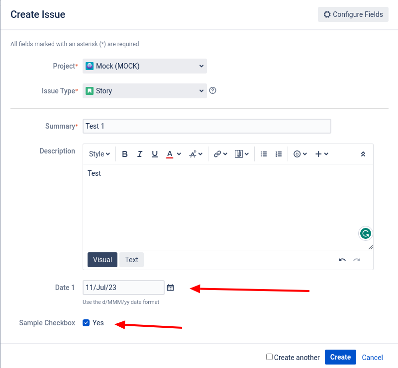

In my environment, I am testing with a Single Select List called Sample List, and it has options Option 1, Option 2, Option 3 and Option 4. So in the create screen if Option 1 is selected the Date 1 field will be updated to the current date.
Also if I try to edit the issue, the value for the Date 1 field is not changed. Only if I change the option from the Select List does the Date 1 field get updated.

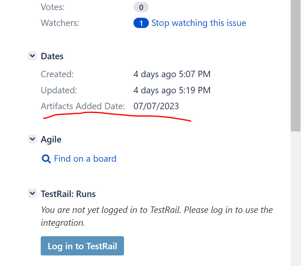

"Artifacts Ready" is a check box with the single option "Yes," and "Artifacts Added Date" is a date field. I updated the addon version to 8.6.0. I tried on the dev instance, but it's still updating to the current date when I updated other fields.
If you check the attached screenshot, the "Artifacts Added Date" is 07/07/2023, but when I opened the edit, "Artifacts Added Date" is 11/July/2023. I didn't update anything; I just clicked on edit, the date showing the current date. Is there any mistake in my script?
I think, When opening the edit, there is a pre-checked box with a single value of "Yes." Additionally, the date field is being considered for an update.

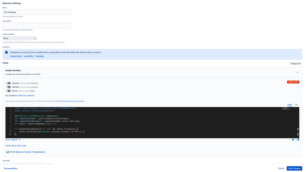

I have re-run the test once again, this time using the check box instead of the list, and I am still not encountering any issues.
Below is the working sample code that I have tested with:-
import com.onresolve.jira.groovy.user.FieldBehaviours
import groovy.transform.BaseScript
@BaseScript FieldBehaviours behaviours
def sampleCheckBox = getFieldById(fieldChanged)
def sampleCheckBoxValue = sampleCheckBox.value.toString()
def date1 = getFieldByName('Date 1')
if (sampleCheckBoxValue == 'Yes' && !date1.formValue) {
date1.setFormValue(Calendar.instance.format('dd/MMM/yy'))
Please note that the working sample code above is not 100% exact to your environment. Hence, you will need to make the modifications.
Below is a screenshot of the Server-Side Behaviour configuration.
I suspect the root cause of your problem is the approach you used to set the if/else condition. In your if condition below, you have only checked if the Artifacts field has a value, but you have not checked if the date field has a value or not, as I have done in my example above. This is what is causing the date field to keep updating.
if (Artifacts.getValue() == "Yes") {
    ArtifactDate.setFormValue(Calendar.getInstance().format("d/MMM/yy"))
} else {
    ArtifactDate.setFormValue(null)

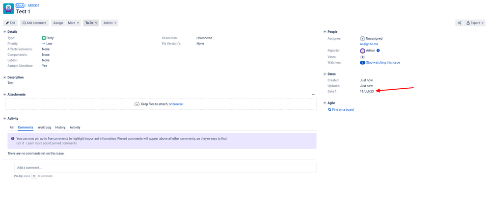

1) I created the issue on 11 July, and the date was set as expected.
2) Below is the view screen where the date field is set to 11 July.
3) Today, on 13 June, I tried to edit the issue, but the date has not been updated as shown in the screenshot below:-test3.png
