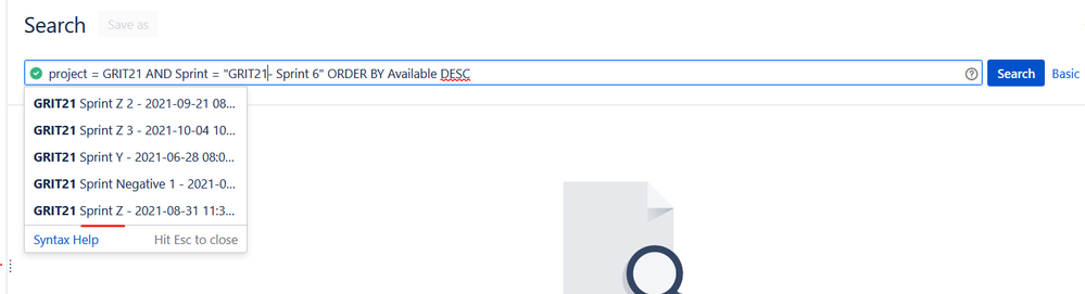

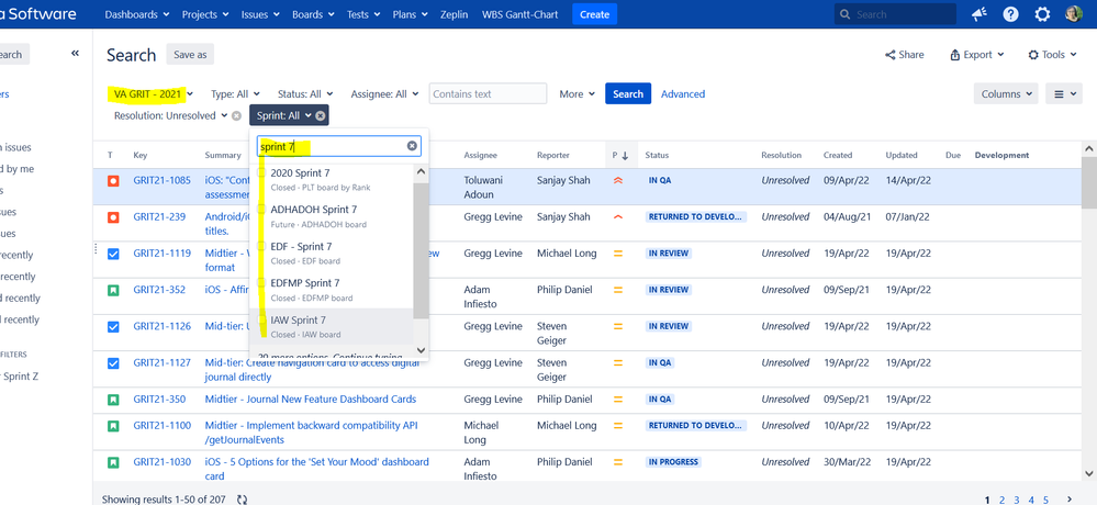

I set project name as "GRIT21", and then add one more filter "Sprint", but when i search specific sprint(e.g: sprint 6, sprint 7), the search result not show, the option list all from other teams, that are not any related with my search project "GRIT21"
The link is :URL
i also using advanced queries when searching (e.g. project = GRIT21 AND Sprint = "GRIT21-Sprint 6" ORDER BY priority DESC, updated DESC ), it doesn't working as expect as well.

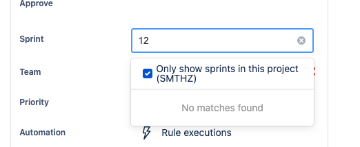

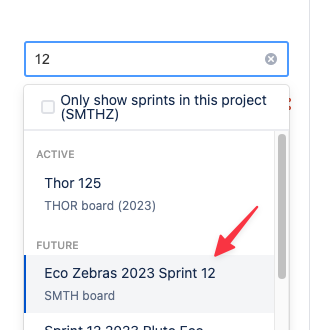

It doesn't work properly for me either when I am trying to assign an issue to a sprint.

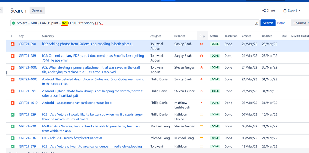

Remove project name in JQL and query directly by the sprint name or sprint id. Does it return the expected result?
liu shi yang April 19, 2022
Hello @Ollie Guan thanks for your quickly response, where can find the sprint id?
Ollie Guan
April 19, 2022

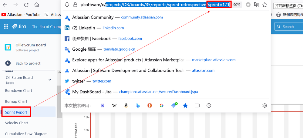

Get the sprint id from the address bar in the active sprints or sprint report.
liu shi yang April 20, 2022

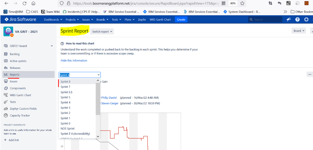

@Ollie Guan Thanks for your guide, i can use the sprint id to find the issue result, and maybe i can suggest our user to use sprint report to view each sprint report, but is there a button in there then can export the report directly?
i can suggest user to use above method to get their project sprint report, but i think is a temporary method, right? if can fix this sprint filter function will be great. otherwise have to find sprint id each time. Thankssearch issues by sprint id.PNG
