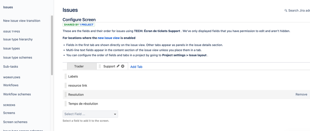

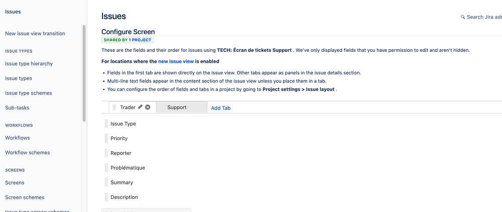

I have configured a specific screen for a specific issue type that I called "Support request". It gathers two tabs with different fields, as shown below:
Capture d’écran 2022-09-23 à 09.38.37.pngCapture d’écran 2022-09-23 à 09.38.42.png
You can see that I have put the "Resolution" field in the second tab.

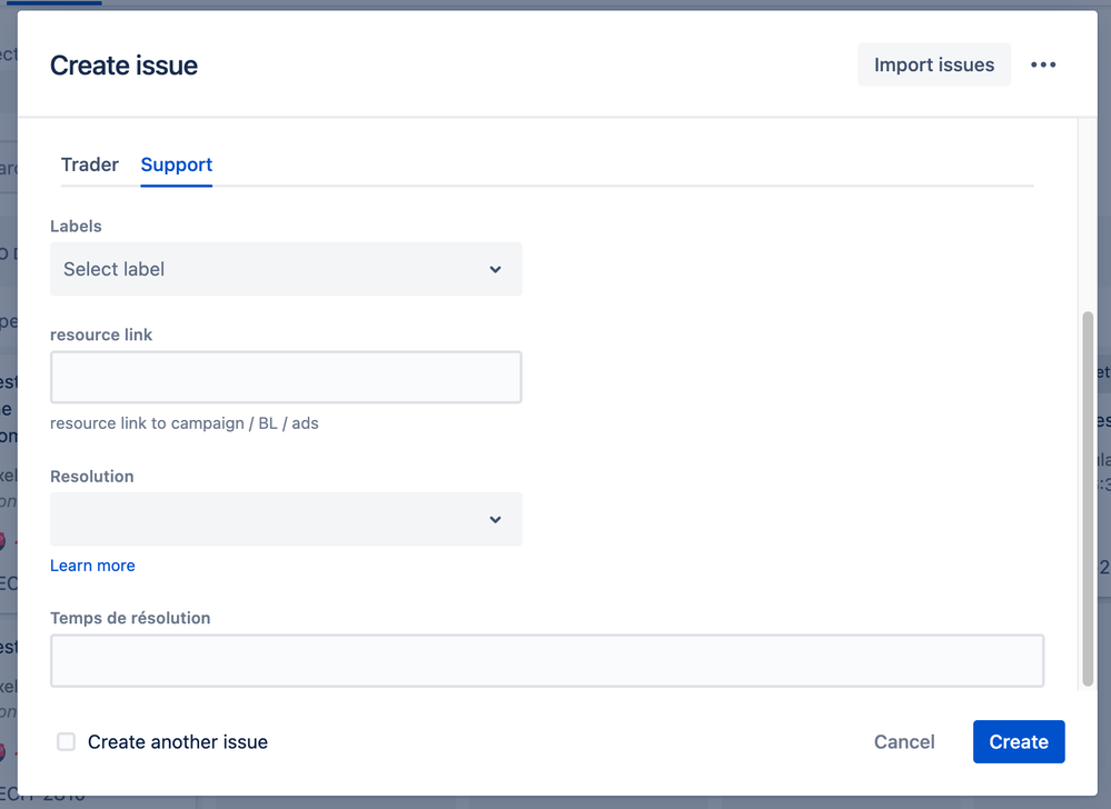

When I create a ticket "Support request", this field does appear:

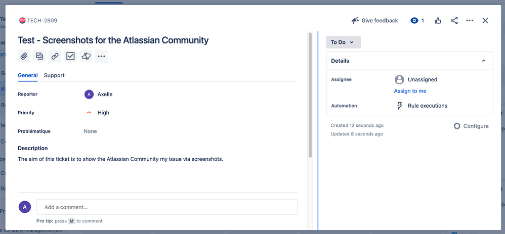

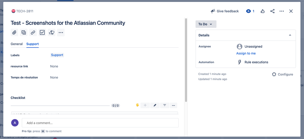

However, once the ticket is created and that I want to check it from my board or my backlog, this field is not displayed anymore (in neither of the tabs):

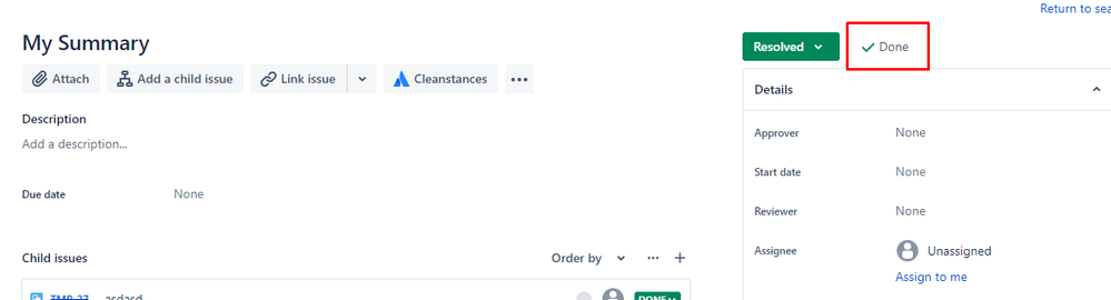

Resolution field, but also other fields as well placed inside a screen, are visible when populated. However, resolution is a systemic field which you can't simply edit. Consider it as a very special field. Resolution appears next to the status, when and if populated:

I made the mistake of adding the Resolution field to my default edit screen in one of my transitions. I figured out right away that was a mistaken. Then I realized Jira included a Resolution screen with a few simple fields that a reasonable person would edit when closing out an issue. So when I transition the issue to the last state in the workflow the resolution screen is displayed and I have the ability to select from a list of resolutions and close the issue. Once that is done. The resolution is displayed next to the state button.

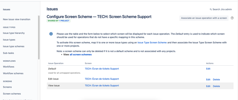

  2. "To a field to be available in screen after ticket is created, [...] then the Resolution field should be added in Edit screen of the ticket type."
    1. Even if it is not set in "View screen" or "Edit screen", it is said that this screen is applied to any unmapped actions by default.
    2. Anyway, I did try, but no change (see below)
