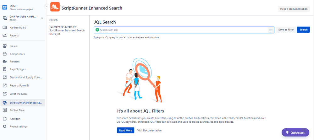

Can i get help on below snip? Why is this suddenly happening? any idea?

HI Anurdha,
On your screenshot, you are on the enhanced search page and not on the listener's page which is under the site admin pages and you can access using the link I provided earlier or using the steps in the page which Mohamed linked to.
Kristian
use the link provided by Kristian, and make sure you have the jira-administrator right
Hi @Mohamed Benziane @Kristian Walker _Adaptavist_ ,
Sorry i was checking in wrong page.
Now i Got it. As Im just 2 months in groovy. Can u please help me here.? where to see the changes for the group filed?

Hi, I see its a multifield selector.
does it help?
Hi Anuradha
Can you send go to the page at <JiraCloudBaseURL>/secure/admin/ViewCustomFields.jspa from before you click on the field and to confirm what type it says the field is in the Type column as I will need to know this type in order to advise further as your screenshot does not show the type of the field.
Kristian
In the above Snip user wants to change status of group filed to none. But the script runner is now allowing
Hi Anurdhava,
Thank you for your response.
This indicates the field is a Single Select List field.
From the field, I can confirm it does not have an option configured called None so you cannot configure this to have a value of None unless you
However, if you want to clear the field so it has no value set then you can do this by setting the field value to null In your script to Null.
I can confirm we have an example script located here which shows how to clear values of different field types when cloning an issue and this script can be used as a reference guide to show how you can clear the field value for your Single Select List field named Group.
I hope this information helps.
