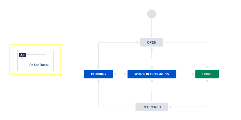

Suppose he sets a wrong resolution then I would like to add a transition from "Done" to "Done" so that the resolution screen appears again and user gets a chance to correct the resolution rather than going back to "In Progress" and then transition it back to "Done".
In the work flow I have set this resolution and i have set the screen name properly.

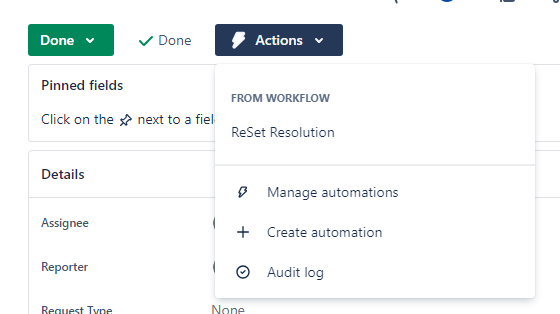

I was looking in the Transition drop down list. But it is in the "Actions" drop down list now.

Hi @Evgenii Thank you for your answer. Do you know why Atlassian has added this to the Actions List and not the Transitions drop down? If I configure the self transition to be visible in the Customer Portal then it displays in the portal with all the other Customer Portal transitions.
Hi, @Kasturee
Sorry, I don't know, what was the root reason, why Atlassian UI designers decided, that it must be in another place. It's weird solution.
