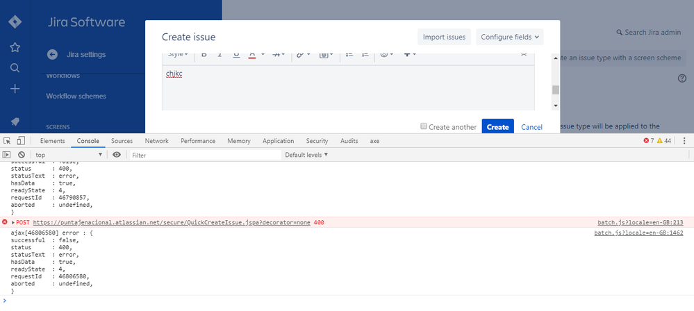

Hello! I am facing a possible bug probably.
I am trying to create an issue of a recently created new issue type "Consulta OGR mantención". The system is obligating me to fill a "required" field "Usuario utilizado", which is not associated with the screen of this issue type.
Can you please advice how can I resolve it?
Regards
Welcome to the Atlassian Community~
This warning will be displayed if the field is configured as required on the Field configuration although it is not added to the screen.
It is possible that the project is using the System Default Field Configuration.
You can check this by going into the Project Settings > Fields. Are you able to see this field there and configured to Required = Yes.
Adrian Stephen
You can use a new field configuration & field configuration scheme where the field is not required to avoid this.
Thank you Adrian! With new field_configuration it works fine :)
Glad to hear that @olga.sidorenko ! If my answer helped, please click on “Accept Answer” so that it can help other users in similar situations.
