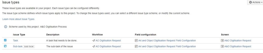

I have created a Project with a custom workflow (1st time I've done this so that could be a problem) but when I attempt to edit the ISsue Type I get the following message:
"There are no issue types with compatible field configuration and/or workflow associations". I only have two issue types in the project - Task and Sub Task.

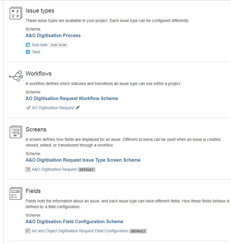

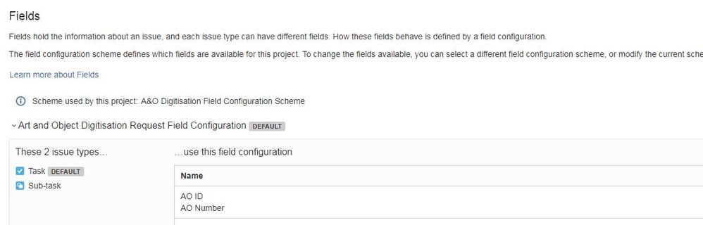

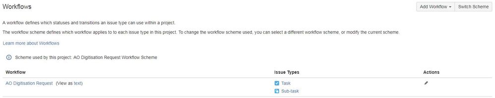

I have checked the Workflow scheme, the Screen scheme and the Field Configuration scheme and they all have the Issue Types associated.

Despite the two issue types having the same configuration, they are of two incompatible types - standard and subtask. The one fundamental difference between them is stopping your edit. Subtasks have a mandatory parent field, standard issues cannot have one.
Try using "convert to standard/sub-task" on the options menu for the issue instead. That will ask for a parent, or strip it, depending on which way you're going.
