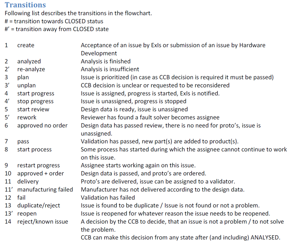

So I have a choice: Do I create a workflow similar to the current system, or do I create a more agile workflow.
I think an agile approach using KanBan will fit.
Basically my interpretation is: The Engineer picks the most important issue and is assigned to only that issue (with exception of some standalone processes).
Agile Hardware Workflows are hard to find, so I tried making one.
Following images contain my proposal, it might violate some Jira "must haves" (like an open state).
Feel free to comment on it, but above all I would like to see and learn from your Hardware Development Workflow.

Would you use the proposed workflow for one issue type or all issue types in the hardware project? You can also have different workflows for different issue types (would need to use workflow schemes to match a workflow with an issue type).
The only suggestion I have might be limiting the number of statuses the ticket/issues goes through. This might make the process of opening/closing tickets a bit more faster.
Let me know if you're working with fix versions/releases, I find that part a little tricky with hardware development. I would like to have a discussion about it.
I will start of using this workflow for most of them, only subtask have a different, much smaller, workflow (Scheduled, In Progress, In Review, Closed).
The number of statusses is one of the reasons I posted this thread, because I think I am making it more complex than needed. So I would like to see what you use.

The workflows I use are not created by me but by the admins and I currently can't change them. I'm trying to utilize the pre-determined workflows for hardware product development. Most of the issue types have only Open, In-Progress, and Closed statuses. A few of the issue types also have "assigned" or "on hold".
Since you can configure your workflows anytime, you could try out the workflow you created for a period of time. If you feel like there are too many transitions and statuses, some of them could become tasks or sub-tasks. For example if you think manufacturing doesn't have to be in the workflow, then it could become a sub-task.
Looking back at your workflow, I actually think the number of statuses are fine because they represent important stages in product development. Correct me if I'm wrong, the transitions automatically happen based on the activity in an issue right?

We have a small Team of hardware developers 2 Mechanical Engineers and 3 Electronics Engineers, and a handfull of projects.
I think what you call compartmentalization is my way of trying to have an Agile workflow in which an Egineer works only on the most important task until it is finished before starting on the next. Because for HW-engineering you mostly wait for the complete design is ready before you start a "Build" and "Build" often take 6-10weeks, there is a long time of inactivity on a ticket between finishing progress and starting validation.
To have one in progress item on the board per Developer I created some wait statusses, "Processing" and "Manufacturing".
At this moment I am feeling that this is overcomplicating the workflow, and I feel more like accepting more than one issue/developer to be "In Progress". And thus removing the wait statusses.

Currently we share schematics by linking to the design files. All Engineers (also the relevant SW-engineers) are able to view these files using the free viewer that comes with the E-CAD tool. We do not attach design data to confluence pages, we do document review items in a collaborated page.
The review items are currently done in text and sometimes screenshots of the design details. It would be beneficial to be able to do the commenting directly in the design, but I doubt if Confluence is the place to store and version hardware designs.
For revision control in hardware development many PDM/PLM systems are available. A very important feature of these applications is the connection to an ERP system. These applications are often integrated in a specific CAD-system and can often also show data from other CAD-systems (so you can see MCAD and ECAD information simultaneously).
In our case we have been looking for a PDM-system for a long time, but costs are high and time to research is limited. We mostly do manual revision control, manual imports in ERP and exchange 3D-data manually between ECAD- and MCAD-developers. We can do that because there are a relatively small company where Developers are close to each other.
As I learn more about the software progress the "In Review" step resembles a Pull Request in SW. Colleagues are reviewing the design data before going to the next step. With new designs (sometimes multiple) schematics are reviewed by several people also because there are SW-related elements. For the board design the review is mostly done by 2 E-engineers and one M-engineer.
