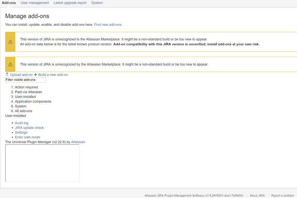

Sorry, it was temporary. Just after few page refreshes it is the same problem again.
UPM is 2.22.6

When you visit the "Manage Addons" page, do you still get any message that UPM or other addons can be updated? If so, I would suggest downloading UPM addon for a manual update.
Aside from that, it may be that the only reliable solution is to do a fresh install using the official installer for the latest version and to migrate any data you have in the previous instance.
But it was an official latest installer. Onlz one thing I did is change from trial license to the one we bought.
Manage addons looks like this
OK, when you installed it, was it on an empty database or an existing jira db? Have you tried running the installer again? To choose Update Existing Installation and let it complete and restart jira, then check the marketplace page again.
