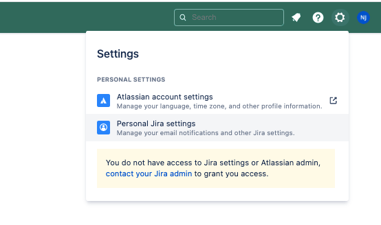

I can see it but i dont see Issue there Screenshot 2021-04-27 at 8.08.19 PM.png
Nic Brough -Adaptavist-
April 27, 2021
The last box in the drop-down tells you what the problem is - you are not an admin.  You will need to talk to your admins.

 I was able to figure out that i was only the Admin of one particular project and not the entire JIRA .
I was granted the access and I am able to add ISSUE type now.
