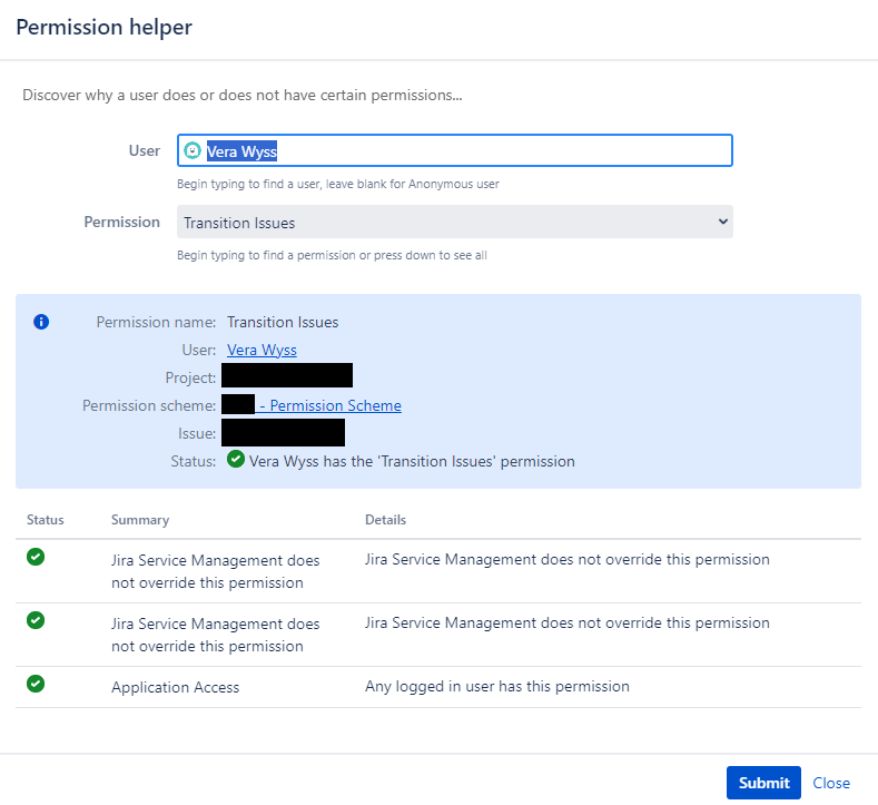

Go to Permission helper.
Press Control + K and type permission helper and check what is the permission missing.
Then check the workflow properties and conditions, the permission must be controlled via workflow properties.
Thanks for sharing, we have now found a solution to fix the problem.
