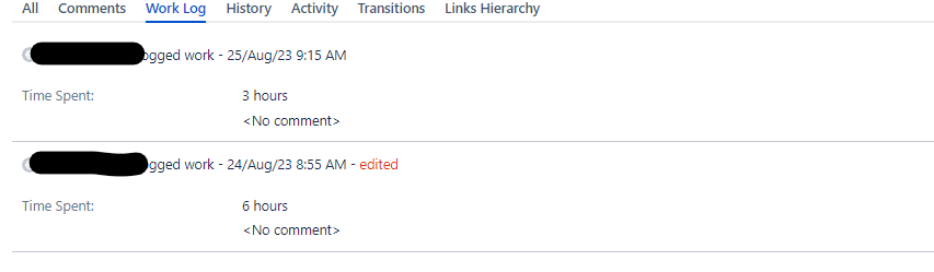

We have a subtask that was given estimate of 1 day value. On the 24th of Aug, they changed it to 2hrs since they over estimated. While on that same day the 24th, they logged 6 hours. Also on the 25th they also logged another 3 hours. Why isn't the burn down charts showing the proper values of 9 hours ?

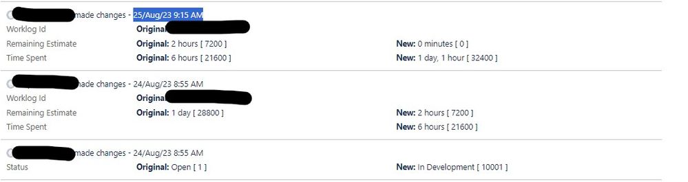

Jira Work Log Audit Trail......

Then why does it show some logged hour records that occurred during the sprint but not all of the logged hours that occurred during the sprint? It shows the work logged on Aug. 25 (3 hours) but doesn't show the work logged on Aug. 24 (6 hours). It only shows "scope changed" on Aug. 24 but with 0 hours. It's as if Jira is not picking up logged hours if they are logged at the same time the sub-task was created. The Work Logged tab of the sub-task shows the right logged hours (3 hours and 6 hours), but the Burndown chart isn't showing the logged hours of the sub-task when it's at the same time as the "scope change" record. That's where the inconsistency seem to lie, regardless of whether or not sub-tasks should be used for sprint work.
