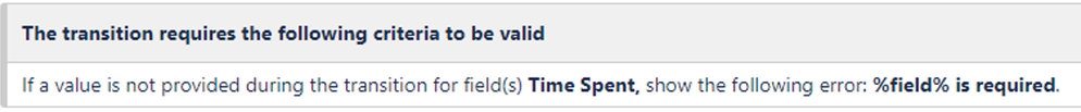

I want to check if the user has logged work against a sub-task when the task is closed. I added a workflow validator, to check time spent. The problem is it always gives a required field error even when I log time against the task. Any thoughts on how to make this work without using any plugins?

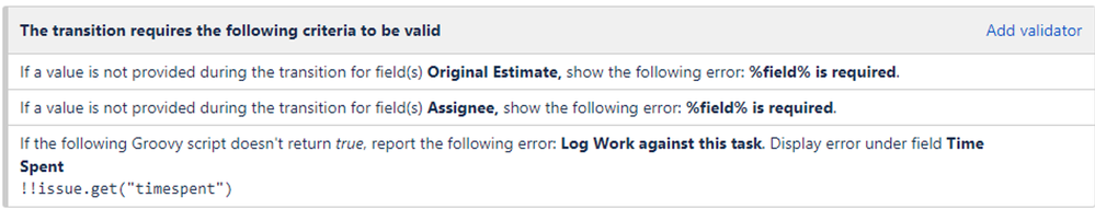

I was able to fix by adding a groovy script to the validator and check for timespent.

I've set up the same transition as @Nagendra Dattatreya ; However I'm always getting the failure even if time was logged prior to moving the issue to the next status. Does anyone have a solution for that which doesn't require writing groovy script to work around (what appears to be a bug)?
Validators are checked on the transition screen.
