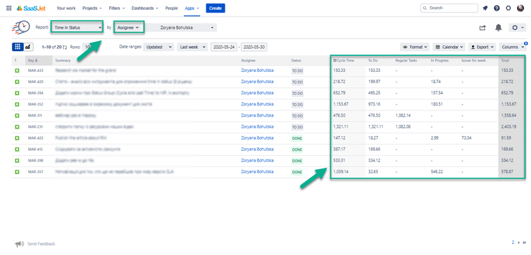

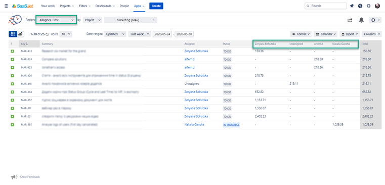

I guess I know a solution that can help you.
Using Time in Status for Jira Cloud you can capture:
Also, add-on let you set users groups to monitor time in status for different teams.
For convenience, you can use graph views or add-ons gadget on Jira dashboard.
Please let me know will it work for you?

I'm glad you found a solution for yourself :) But I want to clarify that the application Time in Status for Jira Cloud can also count time for several assignees who worked on the issue.
