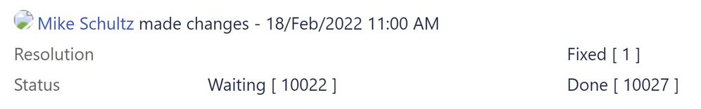

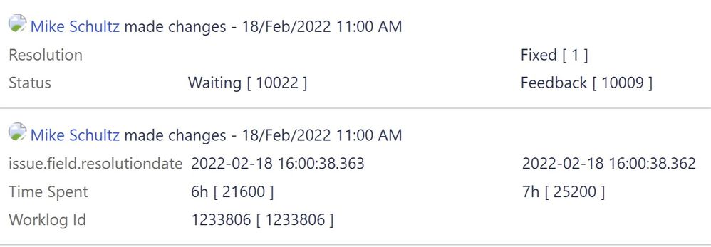

A have two transitions that are identical: Feedback and Done. When moving the issue to Feedback, the resolve issue screen appears with the Time Tracking field present. I enter the Time Spent there and click submit. The time is logged on the issue no problem.
When I transition the issue to Done, using the same transition screen and enter the Time Spent, it's not added to the issue. Has anyone experienced this? Both transitions have the same conditions, validators and post functions present.
History of moving to Feedback and setting Time Spent:
History of moving to Done and setting Time Spent:
