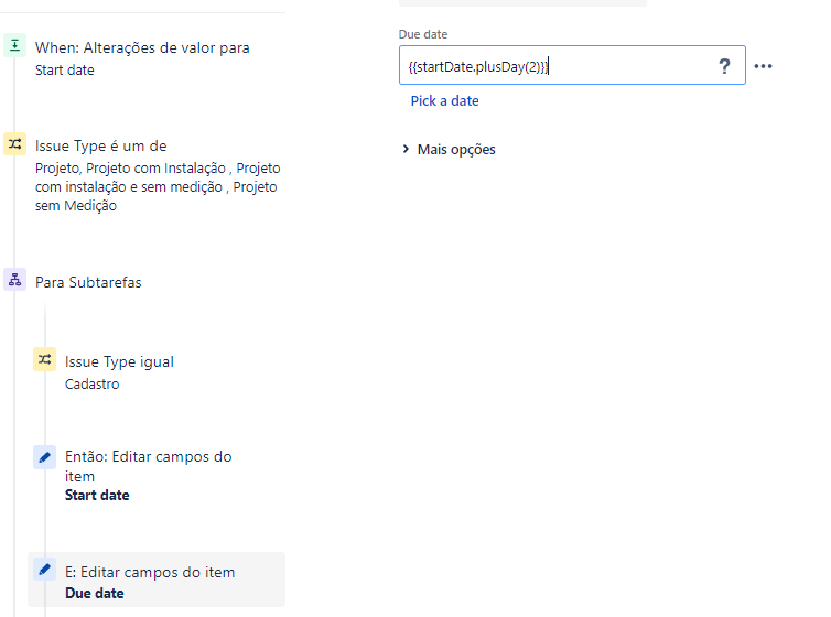

how do I always leave the deadline at a certain number of days from the start date?
I'm using {{startDate.plusDay(2)}} but it's not working.

Adding to what Trudy suggests:
I note in your screen image you have {{startDate.plusDay(2)}}
However the function name is actually plusDays()
Please update that to learn if it helps. Thanks!

Douglas, have you tried the edit issue action, changing your field to be:
{{issue.Start date.plusDays(2)}}
