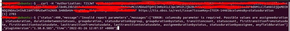

I have tried this but I got this error.
{"status":400,"message":"Invalid report parameters","messages":["ERROR: columnsBy parameter is required. Possible values are assigneeduration, statusduration, durationbetweenstatuses, groupduration, statusdurationbygroup, groupdurationbystatus, transitioncount, statuscount, firsttransitionfromstatusdate, firsttransitiontostatusdate, lasttransitionfromstatusdate, lasttransitiontostatusdate, assigneedurationbystatus, statusdurationbyassignee, anyfieldduration"],"pluginVersion":"1.50.0.585","time":"2022-01-25 12:30:45 +0000"}
So, error 400 means, that authorization is ok, but you are sending invalid parameters for the report. But it is weird, because according to the error message - columnsBy parameter is missing, but you are sending it.
Have you tried to use "statusduration" value instead of "statusDuration"?
I have tried both but no luck. Kindly check the below image.
