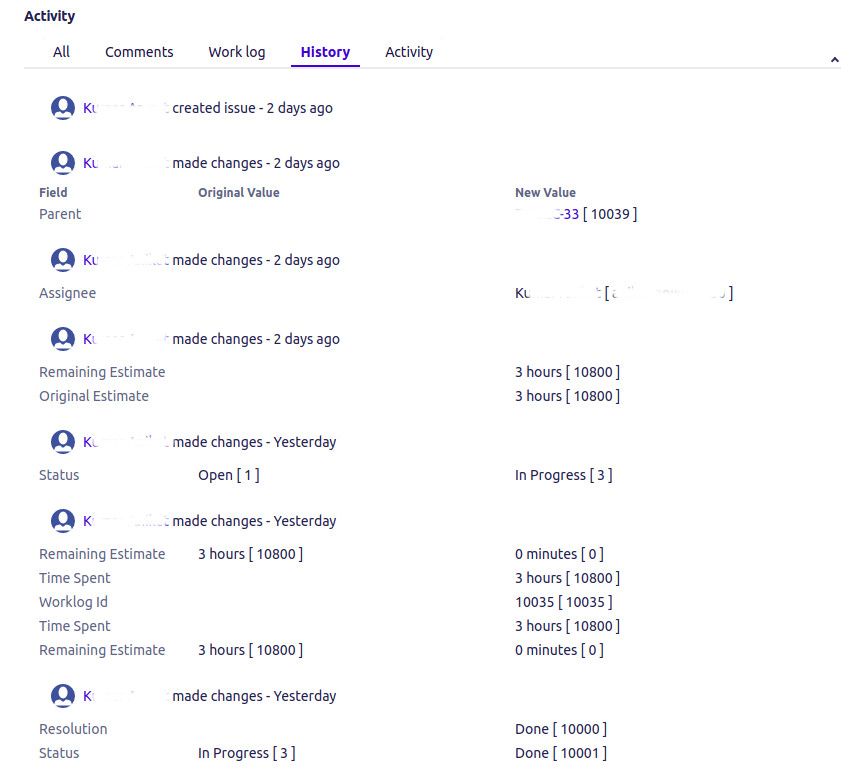

For this Sub-Task below the time logged is counted in burndown

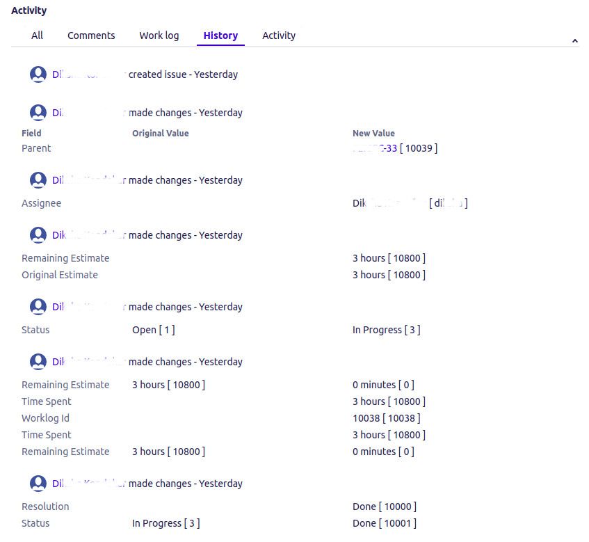

For this Sub-Task below the time logged is NOT counted in burndown
That is correct, sub-task estimates do not burn-down.
They can not, because the point of a scrum is that you either deliver a story or you do not. There is no partial delivery, so the estimates on a sub-task are irrelevant to a burn down.
(They can be useful in other ways, but using them causes complexity that Atlassian have chosen to ignore by saying "estimate on the story level only", where some other tools botch it, either breaking scrum or imposing often confusing methods of handling it that only work for a sub-section of their users)
