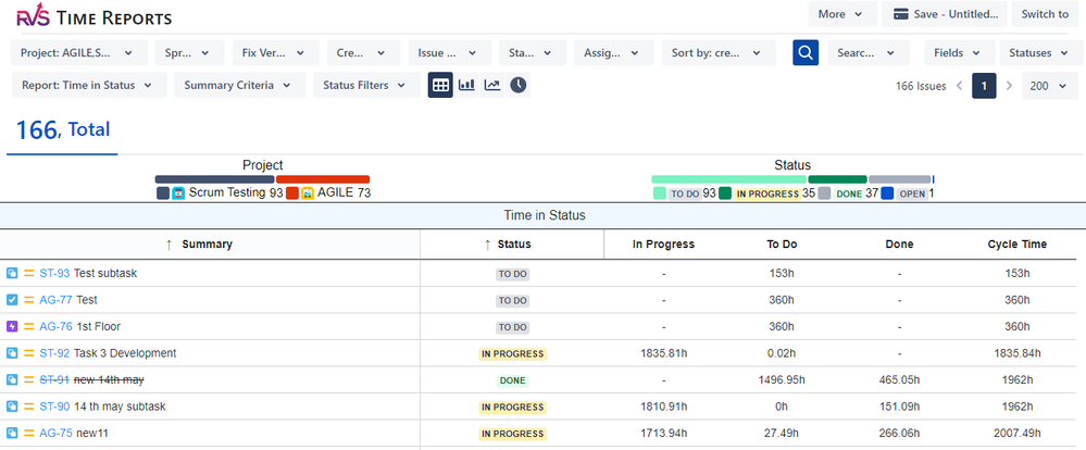

If you prefer to use a marketplace app, you can try Status Time Reports app developed by our team. It mainly provides reports and gadgets based on how much time passed in each status.
Here is the online demo link, you can see it in action and try without installing the app. For further details, please see Status Time Reports How to Videos.
If you are looking for a completely free solution, you can try the limited version Status Time Free.
Hope it helps.
Will this automatically track when an issue is moved to "pending" and when it is moved to "done" and find the difference to calculate the total time worked without any type of manual entry?
Implicitly yes. It can calculate the time passed in each statuses between pending and done. In the app you can group the statuses you want to get the total time. Given that you have the following workflow
New -> Pending -> In Development -> In Testing -> Done
then the app can track the time passed in "Pending+In Development+In Testing" and displays this total time(aka cycle time) in a report. You can
