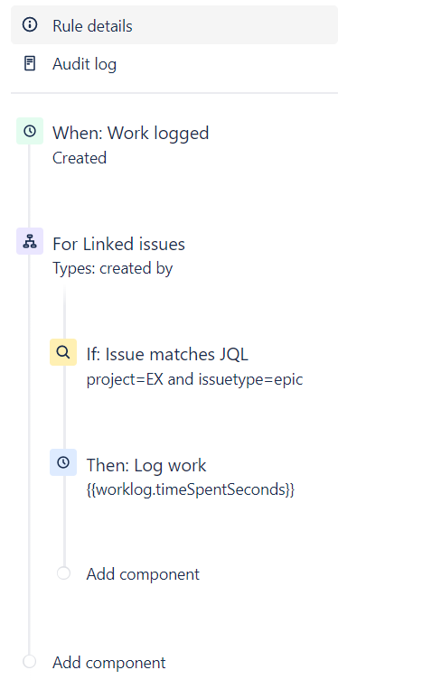

I made an automation rules to add the work log from multiple project's task to the Epic. Seem like the rule is fine because it's running successfully. But when I log time by hour in the task, it will be display as weeks and the number is also showed wrong. What happened with my rule and how can I fix it?
Here is the rule:
Here is the error:

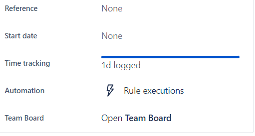

The time I log in a task of project A. I add some hours and it becomes 1d.
The time tracking in Epic of Project B goes wrong:

Hi @Tien Nguyen
Can you try with below Automation (Uncheck the Include Subtasks option if you have any)
Below Reference for Steps
Pramodh
Thanks so much for your support. I've made it successfully with making a little bit change with name to suit with my project. Again, thank you!
