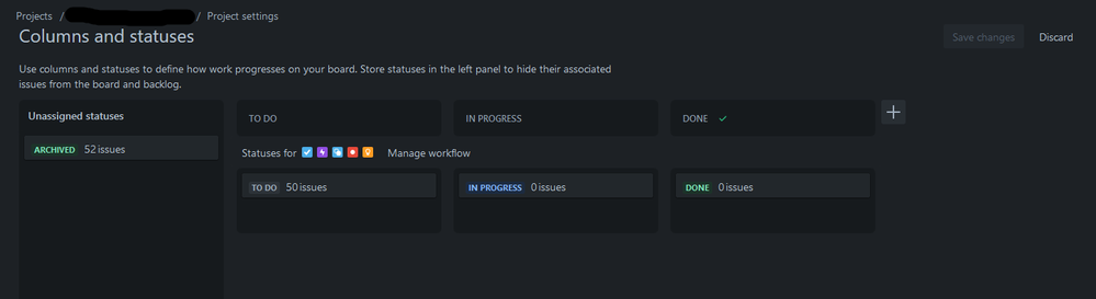

@Jussi SoroI don't see anything like this there. I can only change the columns and statuses from this page.
Oh, that's different in Team Managed projects. You can't edit the board filters on team managed projects, as they always only bring the issues in that project. So your problem might be somewhere else than filter. I don't have an answer for that though, why that is happening.
