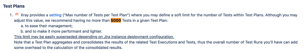

Hi Team,
My requirement is to add 8000 test cases under a single test plan. I read a page (https://confluence.xpand-it.com/display/public/XRAY/Usage+tips+to+improve+performance) Screen Shot 2020-03-13 at 2.02.37 PM.pngwhere they recommend 5000 to be maximum number but we need to add 8000 cases to a single test plan.
We are using jira server model with version as 8.4.1
Can you please suggest a best solution for this ????? can we increase the "Tests per test plan" as 8000 in miscellaneous setting under xray ???

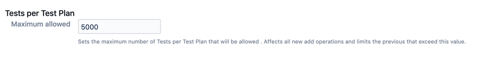

Hi Rahi,
There is a setting on the Xray admin settings which sets the maximum amount of Tests in a Test Plan - "Max number of Tests per Test Plan";  to change it you need to (as admin) navigate to your admin panel -> manage addons -> Xray settings -> Misc and then edit the value.
Our recommendation for the newest version of Xray (3.6.x+) is a maximum of 5000 (up from 2000 previously).
But please be aware that increasing this setting to a much higher value could cause performance issues.
For more questions, please contact our service desk.

Hi Rahi,
Yes, you are able to change it in the configurations.
If you need support in the process, please contact our service desk.
