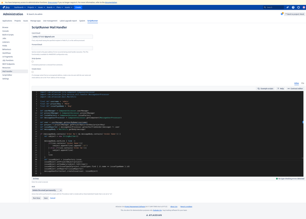

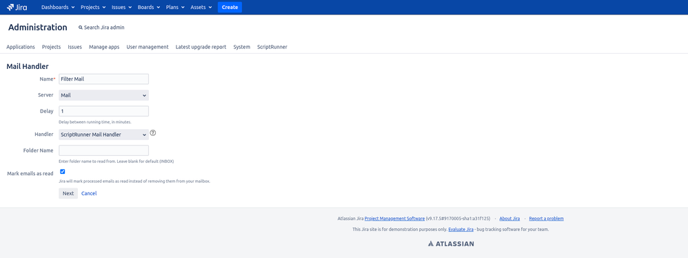

Below are the screenshots of the Mail Handler configurations:-

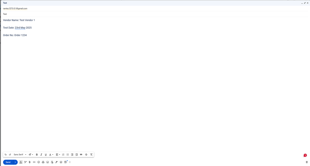

Below is the sample email that is tested:-

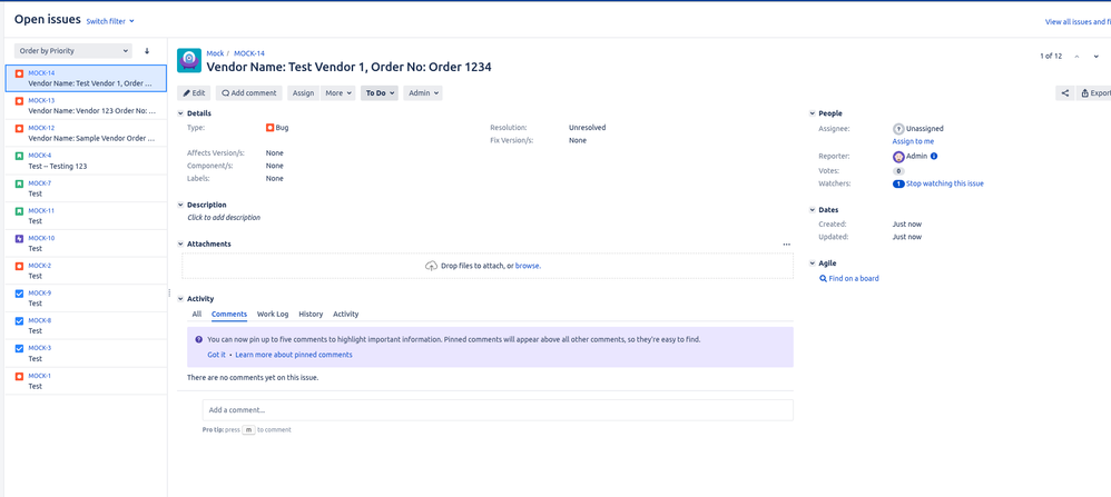

And below is a sample of the output that is produced:-

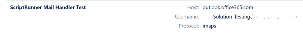

1. Created a mail server with some email addresses and Impas (screenshot attached)
2. Using the same mail server, I set up an incoming email handler (screenshot attached)
3. The catch email address is where we will get the emails, and the same one I mentioned when I created the mail server.

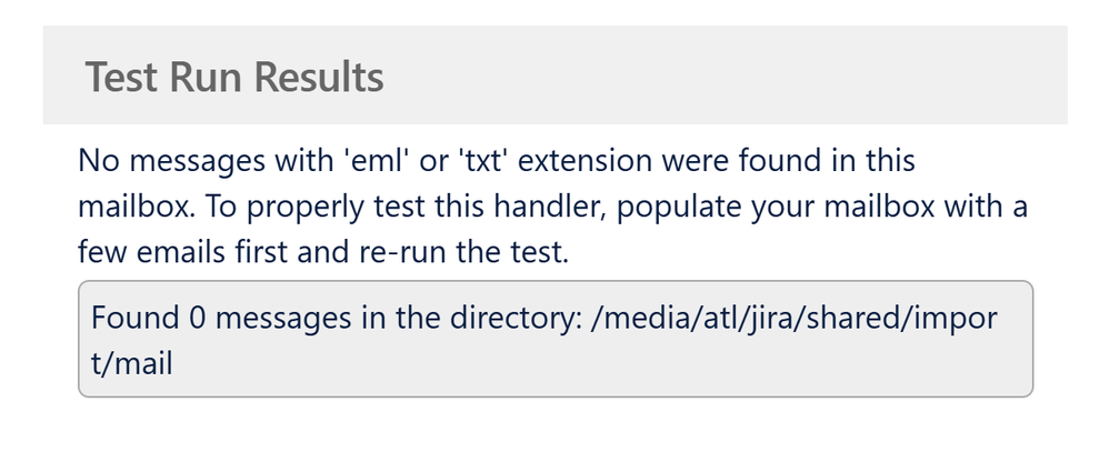

4. I sent a few emails to that email address, and click on "Run Now" to test mail, it's not creating tickets, and showing the message (screenshot attached)

The Run Now test works if you are doing an offline test, i.e. if the email you are testing is stored in the /media/atl/jira/share/import/mail folder in the *.eml or *.txt file format.
However, if you intend to trigger the test via your Outlook server, you need to try sending an actual email to the address configured for the mail handler.
You can still test it offline. To do so, export the email from your Outlook instance, save it as a *.eml file in the /media/atl/jira/share/import/mail folder, and click on the Run Now button to see if it can read the email.

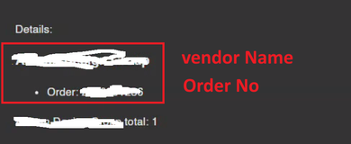

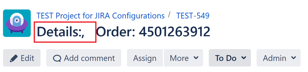

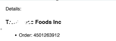

Yes Ram, I sent a few emails, and the tickets have been created correctly. The email of the body formatted this way, but the ticket summary shows like this. Do you know how to correct this?
I want to display the summary like this "TXXXX Foods Inc, Order:4501263912"
Ram Kumar Aravindakshan _Adaptavist_
May 30, 2025
Hi @Lakshmi CH
It's not extracting the Vendor's name because the vendor name is not on the same line as the Details:
Please clarify, are all the Vendor names below the Details?  If yes, then there is a slight modification required in the code.
