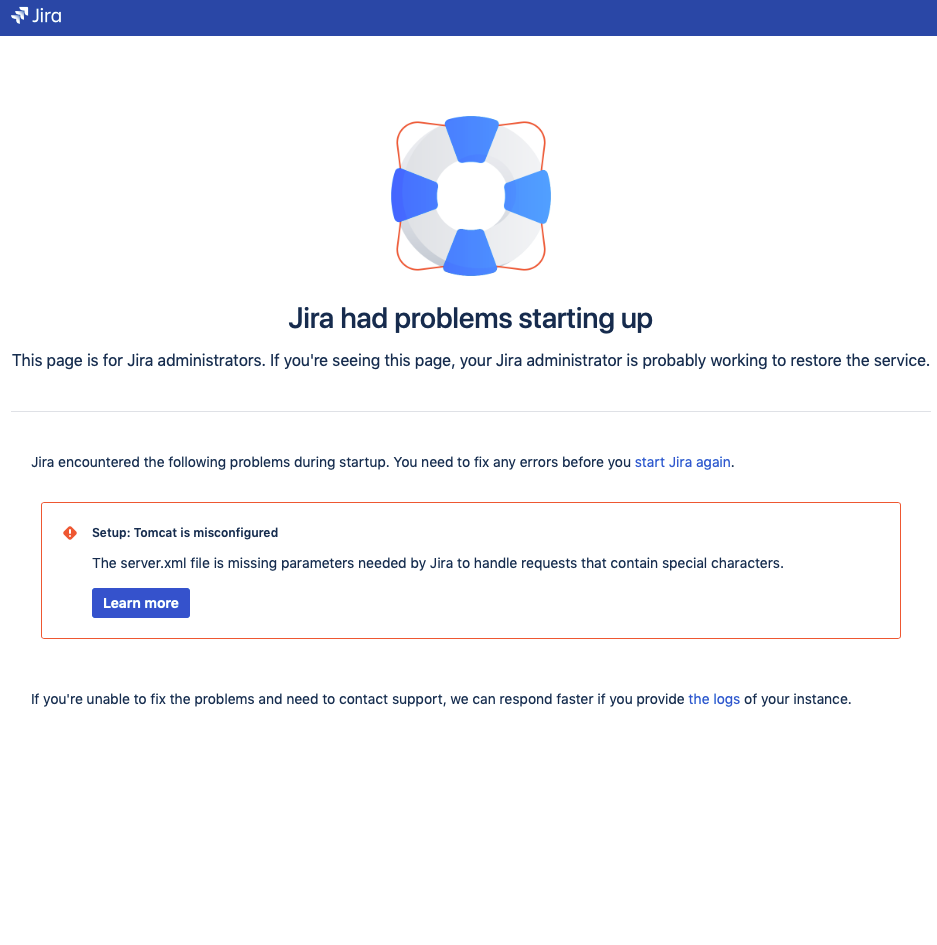

Hello all, super new to Jira and tomcat, but I managed to follow a guide and quickly install SSL, the redirect works, but after following the documentation to add these
Add relaxedPathChars="[]|" relaxedQueryChars="[]|{}^\`"<>"
to the connector properties in server.xml
It seems like my Jira software is still telling me what the picture says
Do take note I am self-hosting, provided I have listed the logs from catalina.out, and my server.xml configuration files.

2018-12-22 14:01:10,680 JIRA-Bootstrap ERROR [c.a.j.health.checks.TomcatConfigurationHealthCheck]
Required path chars: [ ] |
Configured path chars: null []|
Required query chars: [ ] | { } ^ \ ` " < >
Configured query chars: null []|{}^\`"<>
2018-12-22 14:01:10,704 JIRA-Bootstrap ERROR [c.a.jira.health.HealthChecks] Tomcat is misconfigured
2018-12-22 14:01:10,704 JIRA-Bootstrap ERROR [c.a.jira.health.HealthChecks] The server.xml file is missing parameters needed by Jira to handle requests that contain special characters.
2018-12-22 14:01:10,704 JIRA-Bootstrap ERROR [c.a.jira.startup.DefaultJiraLauncher] JIRA has failed to start because of the following errors: [(Event: Level = (EventLevel: error) , Key = (EventType:$

Hi Brian,
You need to do this for any connectors your instance is using, so both HTTP and HTTPS.
Can you stop Jira, add it to 8443 as well, and restart?
Shannon
Hey Shannon,
I managed to add this after I added the connectors for the instance.
It works and I forgot to update the answer.
Thank you!
You're welcome! Glad to hear that's exactly what it was!
Shannon
