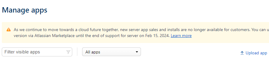

I'm wanting to migrate from Jira server to cloud.
Trying to Install the Jira Cloud Migration Assistant
It says:
To install the assistant:
In Jira Server or Data Center, go to Administration > Manage apps.
Select Find new apps.
Search for Jira Cloud Migration Assistant.
Select Install.
At step 2 it says "End of sale and support for server apps"
and I have no idea how to get past this.
Can someone help?

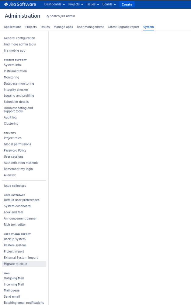

Administration > System > Migrate to Cloud
Is that option available in your system?
However, clicking on it brings up a blank page.
By which I mean a page with the menus and side bar but nothing where information or actions would be.
Odd. If you cannot update the existing App under "Manage Apps" you can maybe try to manually install the App.
You can download it here: Jira Cloud Migration Assistant - Version history | Atlassian Marketplace and install by clicking "Upload App" under Manage Apps.
However, I don't know what happens if the App already exists in your Instance so try that out in your Test Environment first.
I seem to have installed that version manually.
I say it like that because when managing apps I get the error "The base URL configuration of your instance does not match the URL in your browser. This can prevent operations on this page from working correctly". I've checked the setting and it matches the url in the browser.
Ploughing on (since it only says "can prevent", not "will prevent"), I upload the downloaded app and I get "An unexpected error occurred. Refer to the logs for more information." (not sure which log to be looking at).

Clicking "Migrate to cloud" still looks as in the screenshot above.
I'm still not having any success getting "Migrate to cloud " to offer me anything.
