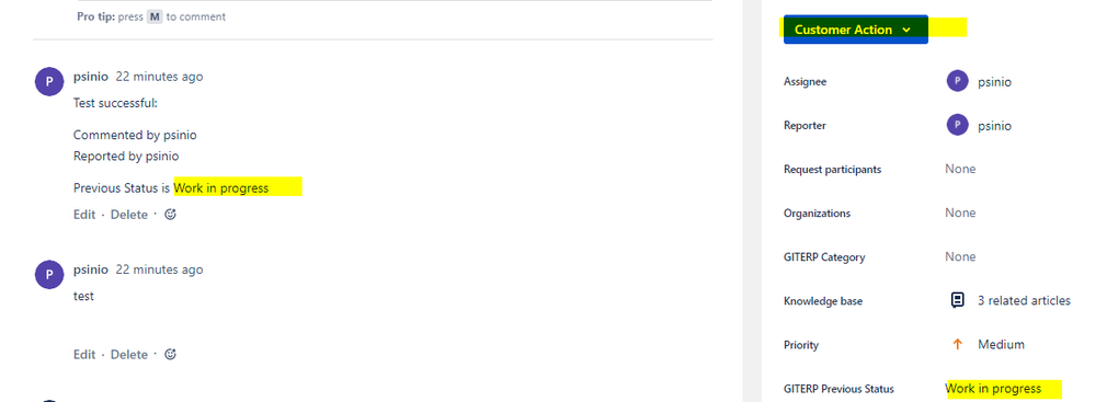

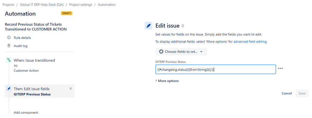

I have 2 rules.  First rule records the previous status in field "GITERP Previous Status" using   {{#changelog.status}}{{fromString}}{{/}}.

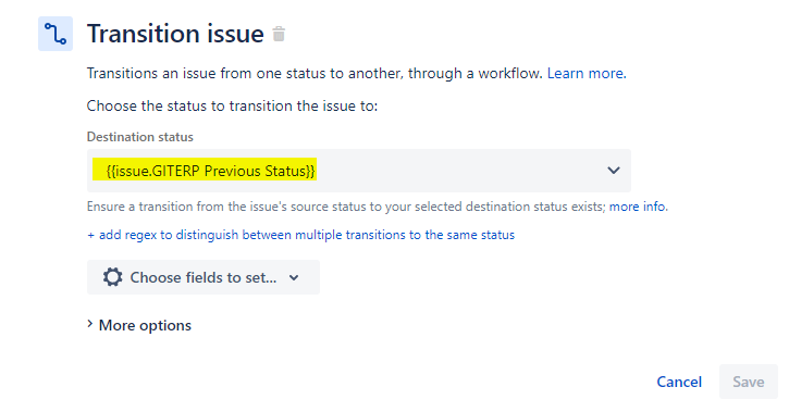

Second rule transitions the status from CUSTOMER ACTION to previous status using smart value   {{issue.GITERP Previous Status}}   in the Transition issue action
During testing, it doesn't automatically transition though.  Logs and comment below.
May i know your thoughts on what is wrong here?  Did i assign the incorrect smart value in the field "GITERP Previous Status"  in the first rule?  What else can i try there?  Thank you

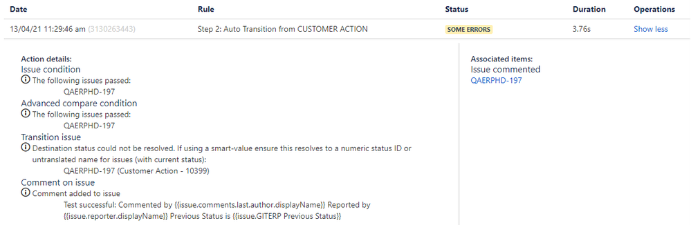

Sinio, Paul Andrew April 13, 2021 edited
Additional changes below were performed but i still get the same error:
"Destination status could not be resolved. If using a smart-value ensure this resolves to a numeric status ID or untranslated name for issues (with current status):
QAERPHD-197 (Customer Action - 10399)"
1.  instead of  {{#changelog.status}}{{fromString}}{{/}},   i used   {{#changelog.status}}{{from}}{{/}}  to store the status ID in GITERP Previous Status in the first rule.
2. i tried different Field Types for "GITERP Previous Status"  (Short Text, Paragraph, Number) to store the status ID.

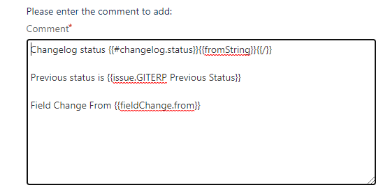

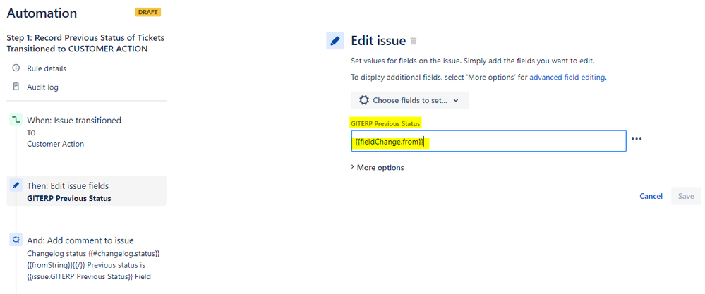

Hi @Ismael Jimoh ,
Yes, i tried the smart value, {{fieldChange.from}}, which was mentioned in the workaround but it seems it doesn't return any value to the field "GITERP Previous Status".  May i know what am i missing?
