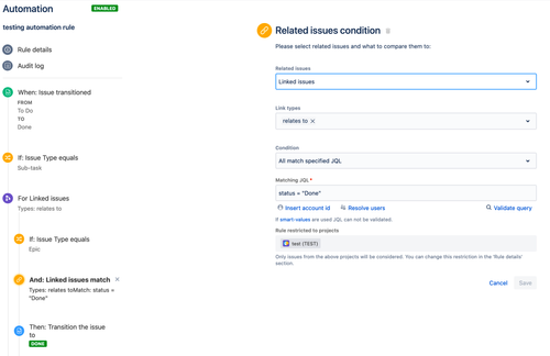

Per your description, I was not able to clearly identify what is the exact relation/link you have configured between your sub-tasks and Epic issues. I believe you have used the default issue link functionality, is that correct?
If that's what you did, you can automatically transition an Epic when ALL the linked sub-tasks are transitioned by using Jira Automation. You can follow the template below where "Relates to" would be the link type you used to link sub-tasks and Epics:
P.S: To ensure the automation above will properly work, you must use an exclusive Link type to link your Sub-tasks and Epics, ensuring this link will not be used to link other issues or for any other purposes.
