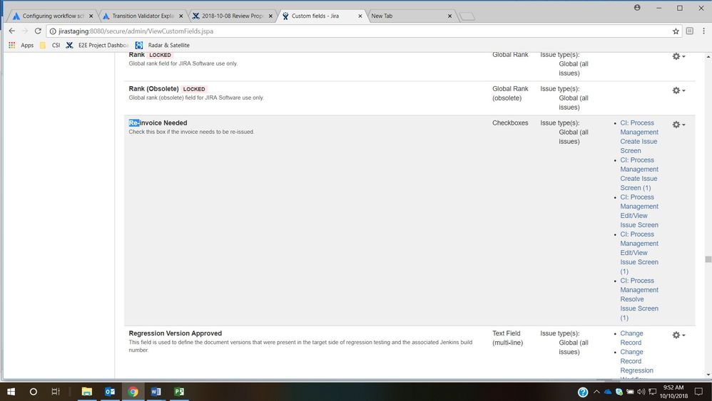

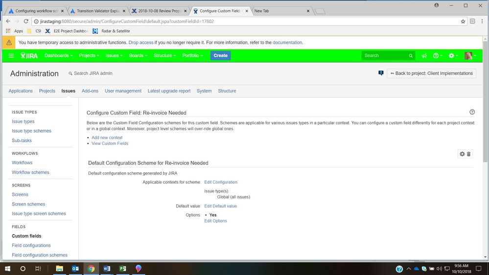

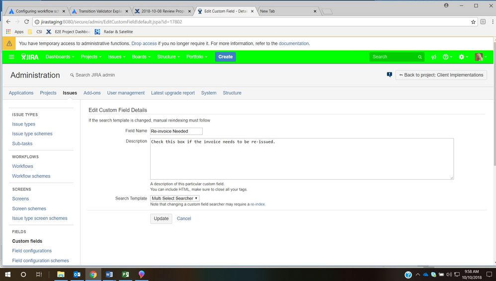

@[deleted] can you please share screenshot of the custom field.
Deleted user October 10, 2018
@Tarun SapraHere are screenshots from the custom field screen, and then the configure and edit screens.  I am able to create an issue with it both checked and unchecked, so it appears to be working as a checkbox.  Check Box1.jpgCheckbox2.jpgCheckbox3.jpg

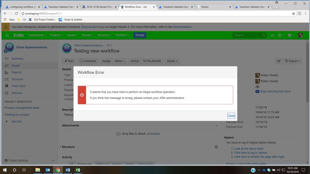

@Tarun Sapra I was very excited and updated the script to include the ! at the beginning.  However, it stops it at both a checked and unchecked box and doesn't give me the error message I defined.  It's a different script, but I'm back to what I had when I first posted.

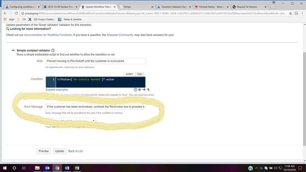

The issue with the box checked was stopped (Yay!), but it's not giving me the error message I entered.
The validator edit screen says  that "The error message that will be provided to the user if the condition is not true" and a check mark (Yes) should mean it's not true, correct?  So I'm not sure what else I need to do to get my message to appear (which tells them to uncheck the box once the invoice has been re-issued) rather than the "You've performed an illegal workflow operation" message.  I don't want my team to think the workflow police are going to get them.  :-)

@Tarun Sapra I didn't mean to say I was using a custom error message.  I'm just using the message on the validator screen.  However, I thank you for all the time and effort you've spent on helping me.  I will continue to work on the error message.  =)
