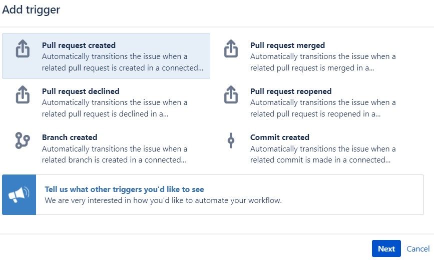

I don't see the Issue Transitioned trigger on the trigger section. How to configure this?
Interesting - It looks like you only have DevOps triggers in your automation (there are several more specific to Jira issues). Does your server instance have this automation add on installed?

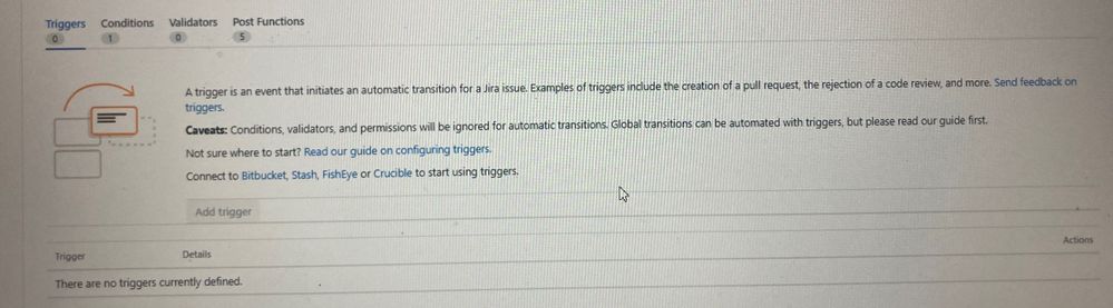

I installed the "Automation for Jira" app to my test instance, but I couldn't configure it.
I tried with the transition based trigger, but not sure how this works on a schedule. This I done it through project not on the workflow transition.
