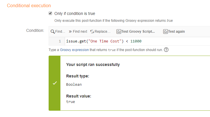

Run this post-function conditionally. issue.get("One-Time Cost") <11000

And then, did you test the script using the Test Groovy Script button on top of the editor?
Even without the conditional execution the jira issue does not transition to the next status as outlined. I did test the script and got not errors.
