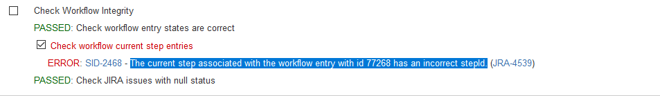

I see this error on my catalina.out
[c.a.jira.workflow.IssueWorkflowManagerImpl] State of issue [SID-2468] has an action [id=601] which cannot be found in the workflow descriptor.
and this is what i see i integrity checker

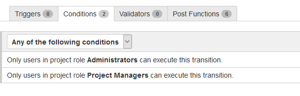

I have the conditions as attachment below.
In this case im in both "administrators" and "Project Managers" roles in the project
Vasiliy Zverev
December 18, 2018
Ok, I see.
Do you have permission to make transitions for this project?
Negin Nafari
December 18, 2018
permission for transition issue is for any logged in user.
