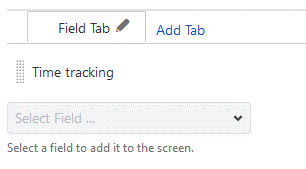

1.- I have created a new window with only the time tracking field.
2.- I am using the default flow adding my screen to the default flow

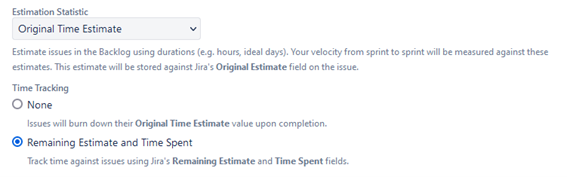

3.- I have configured the project to use Original Time Estimate and time tracking using Remaining Estimate and Time Spent

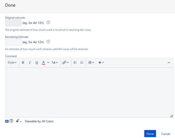

When the transition screen appears only the original estimate and Remaining Estimate is shown.

Hi @Lluís Barbal
In your case you should add "Log work" field on the screen instead of time tracking.

Lluís Barbal October 11, 2023
It worked like a charm. Thanks!

Hi @Lluís Barbal , thanks for your question.
Do you mean that you want to be able to see the hours worked? For this, you would also need to add the 'Log work' field to the screen. Time tracking show, as you see, the estimates and their current state, but to be able to reduce the Remaining Estimate with the time you have spent, you need to add the 'Log work' to this screen.
