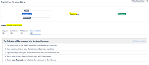

yesterday I came across a case where I do not recall how the details are intended to work.
The setup is a workflow where on "resolve" transition a screen is in place. This screen has the system field "resolution" on it.
That means: every user that is to execute the resolve transition is asked for a resolution - this works for many years, all good.

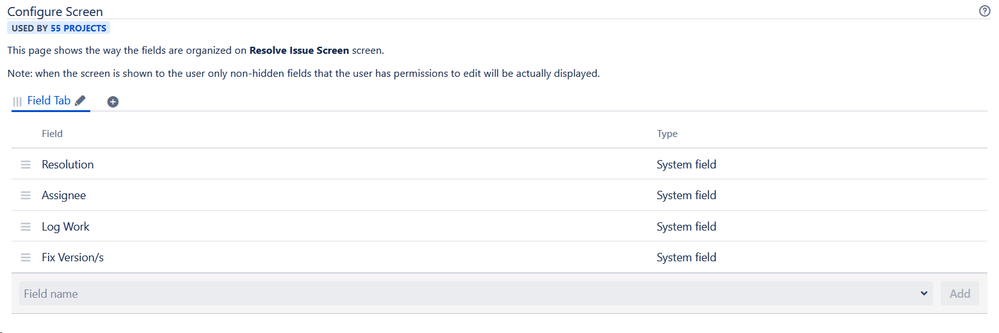

The screen, in my opinion, looks great as well:
