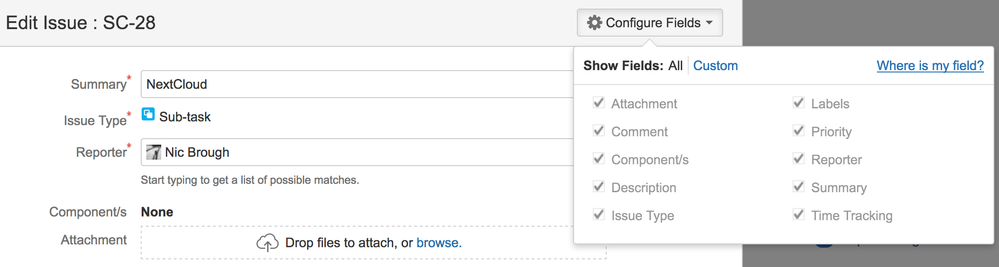

Could you go to "edit" again (full edit, not in-line) and look to the top right for "configure fields".  In that drop-down, there should be a "where's my field" option.  Ask it about "due date", it should tell you why you can't edit it.

Thanks for your reply! In the full edit view I do not seem to have a configure fields drop-down in the right hand corner. In the inline view I do, but I do not have a "where's my field" option. Could this be due to my permissions as a project admin but not Jira admin?

What version of Jira are you on?  You are on the full edit screen, not one of the board ones?  As below (far right)

Bother, I think that may have arrived in 7.3.

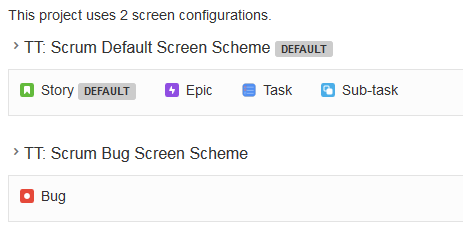

However, your description sounds like you should check the screens in use.  If you can see the field on view, but not edit it (and you have schedule and edit permissions), then it's not on your "edit" screen for this project and issue type.  Have a look at the project's "issue type screen scheme"

This is all it says, should it say more?

No, that's fine.
Descend into the one which matches the issue type for the issue you are trying to get the due date on to.

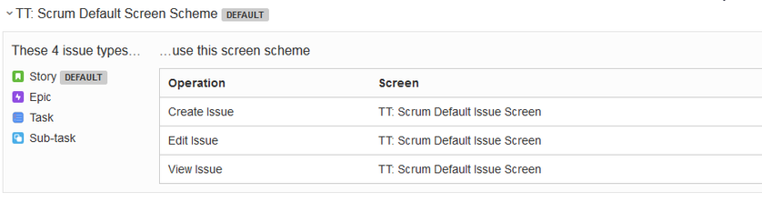

So I can open up the menu but this is all I get, and there's no additional functionality on that page. Story is the issue type I've been trying to add due date to.

That's also good.  Now click on any of the links to TT: Scrum Default Issue Screen
Andrea Lissor Rossi January 24, 2018
I can't, they're not clickable :(
Nic Brough -Adaptavist-
January 24, 2018
That suggests you are not an admin.  As an admin, you need to get into the screen with that name to check that the due date is included there.
