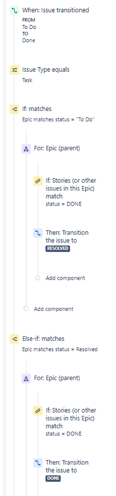

In the example below (statuses replaced by RESOLVED, DONE):
Trigger: a Task transitioning to DONE
IF the parent epic status = CHECKIN
ELSE IF the parent epic status = CUSTOMER JOURNEY
Thank you but i didn't understand how you did the trigger as a task and then you did the condition on an epic without using branching. i don't have this option. I need to create a branch if I want to do a condition on a issue other han the trigger issue.
I used the 'Related issues condition' for this.
Then selected the Epic as related issue and added a matching JQL (status = Checkin).
In this way you can add and IF and an ELSE in the same rule.
You could also split this into two rules and add the status condition in the 'For: Epic' branch.

I tried it but the problem, the actions are not executed on the parent (the Epic). Any action I add on any issue other than the trigger issue, it is not excuted. Even when I used related conditions.
That should be taken care of by the branch 'For: Epic (parent)' you see in the first screenshot.
Select Branch rule / related issues
Select Epic (parent) as type of related issue.
Any actions triggered in this branch will apply to the Epic (parent) of the trigger issue.
This is what I did. I added the transition action to the branch for the Epic. But it is not executed when the trigger happens.
You need to choose 'Epic (parent)' instead of 'Parent' for the branch.
'Parent' typically refers to a Sub-task Parent in Jira.

Hi @Bill Sheboy ,
Thanks for your note.
It did trigger me to test this more thoroughly. Here are the results:
I set up my initial rule (with branch 'Epic (parent)').
-> The test was successful.
Then I copied the rule, replaced the branch selection with 'Parent' and disabled the original rule.
-> No actions were performed.
So I must conclude that the 'Parent' relation does not target the parent epic in the Automation.
Epic (parent)
Automation rule Audit log:
DEMO-210 found and transitioned.
Epic issue history:
Epic transitioned by Automation rule.
Parent
No related issue found, no actions performed.
Epic issue history:
No change on the epic.
